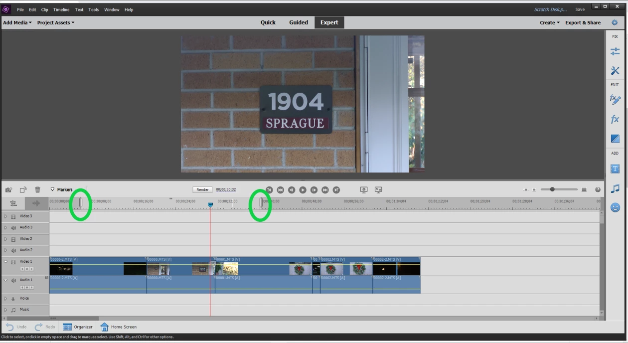

I use PE 2020 and want to extract scenens from a clip to HDD to use them later on for new assemblies.
I have marked, cut the scene, activated the scene, but when  I try to render and export it Premiere only offers me to export the whole clip ! Even with activated "only working area" I get the same result 😞
Please help me, how can I extract only the defined and activated scene from a Clip ???

Apr 7, 2021 12:29 AM UTC
Try setting the work area bars.   You can do that by grabing and sliding them with your mouse.  Or, you can use Alt+[ or Alt+] to set them where the CTI is.   Then at output, check the work area only box.

wolo1952Author
Apr 14, 2021 8:17 AM UTC
Thank You fur your advice, I got it 😊
