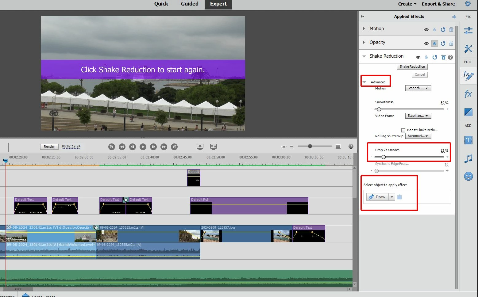

Sep 28, 2024 6:03 AM UTC
See this pre-release version of my video starting at 2:20:  https://youtu.be/0zvX1fey3GQ
The video is only just over 3 minutes long.
This is with Shake Reduction without trying to use "Draw" - I had hoped to do something better!
For screenshot see below - I outlined my settings in RED.

Ann Bens
Sep 27, 2024 6:49 PM UTC
From which effect are you using DRaw as Shake does not have a mask option.
Please post screenshot applied effect with parameters open and screenshot of the ships in question.
