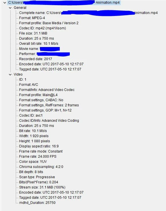

I don't know why this clip won't work in the timeline?
I'm trying to import a clip into the timeline. I have Premier Elements 13. For some reason its not working, It goes blurry and jumpy - looses definition. I'm not sure why?
Here is the clip info:
Thanks 🙂

H.264 MP4.

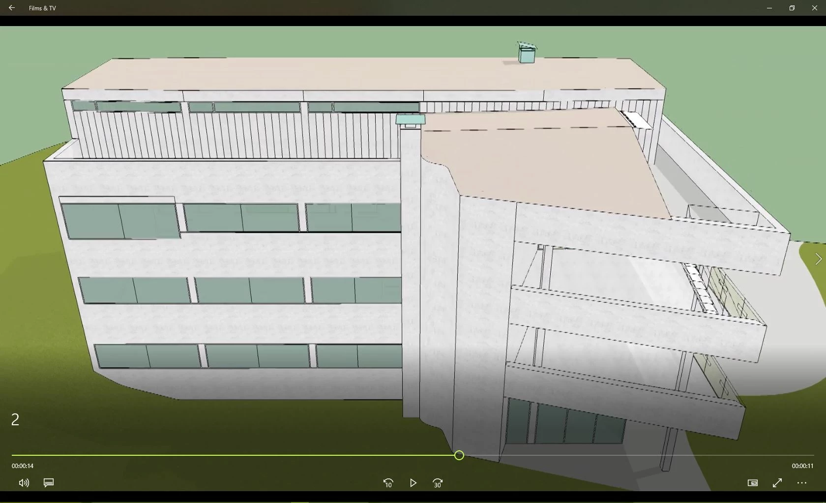

I've just converted it to H.264, but now its doing it even out of Premiere - just playing it in my local media player. I've attached a screenshot. The lines in the building should be solid black, not dotted. Some lines (around the windows and roof) are missing.
Sep 28, 2017 11:48 PM UTC
I agree with Bob. Converting to a more standardized codec will be your best solution. (MP42 is listed as the codec ID no your MediaInfo report.)
