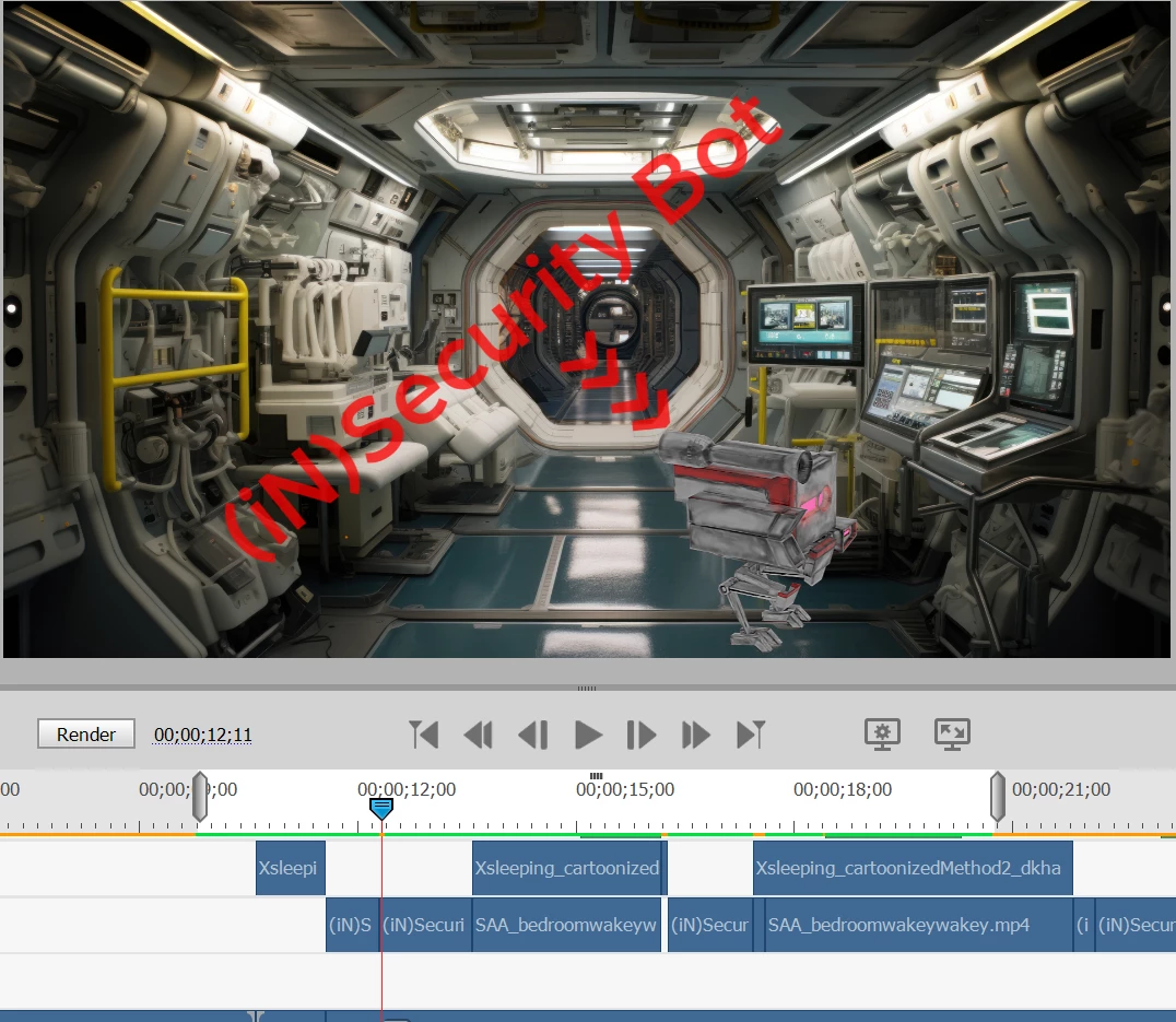

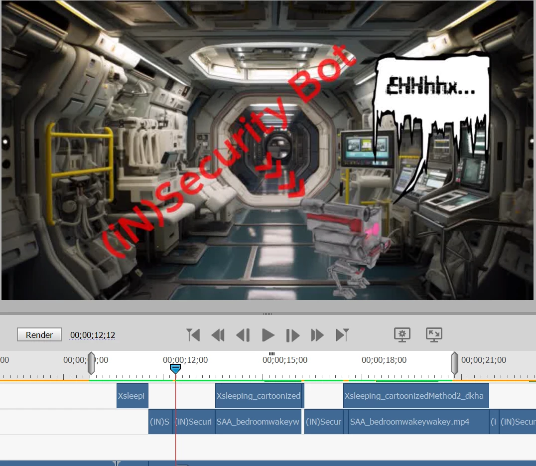

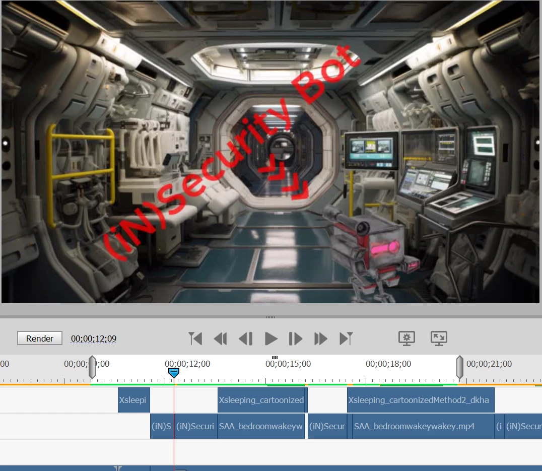

Here are screenshots.  The time is shown for each frame.
00;00;12;09 is when backdrop is scaled a little tall and fuzzy (and all previous frames).
00;00;12;11 is one of the in-between frames when the backdrop is correct.
00;00;12;12 is the first of the subsequent frames when the backdrop once again is slightly stretched and fuzzier.
The change is a few pixels in height, best I can tell, and hard to see just looking at these stills, but it looks quite jarring when the video is playing.  If you were to copy these into your favorite pic viewer and keyboard between them, lined up over each other, you should be able to see it.

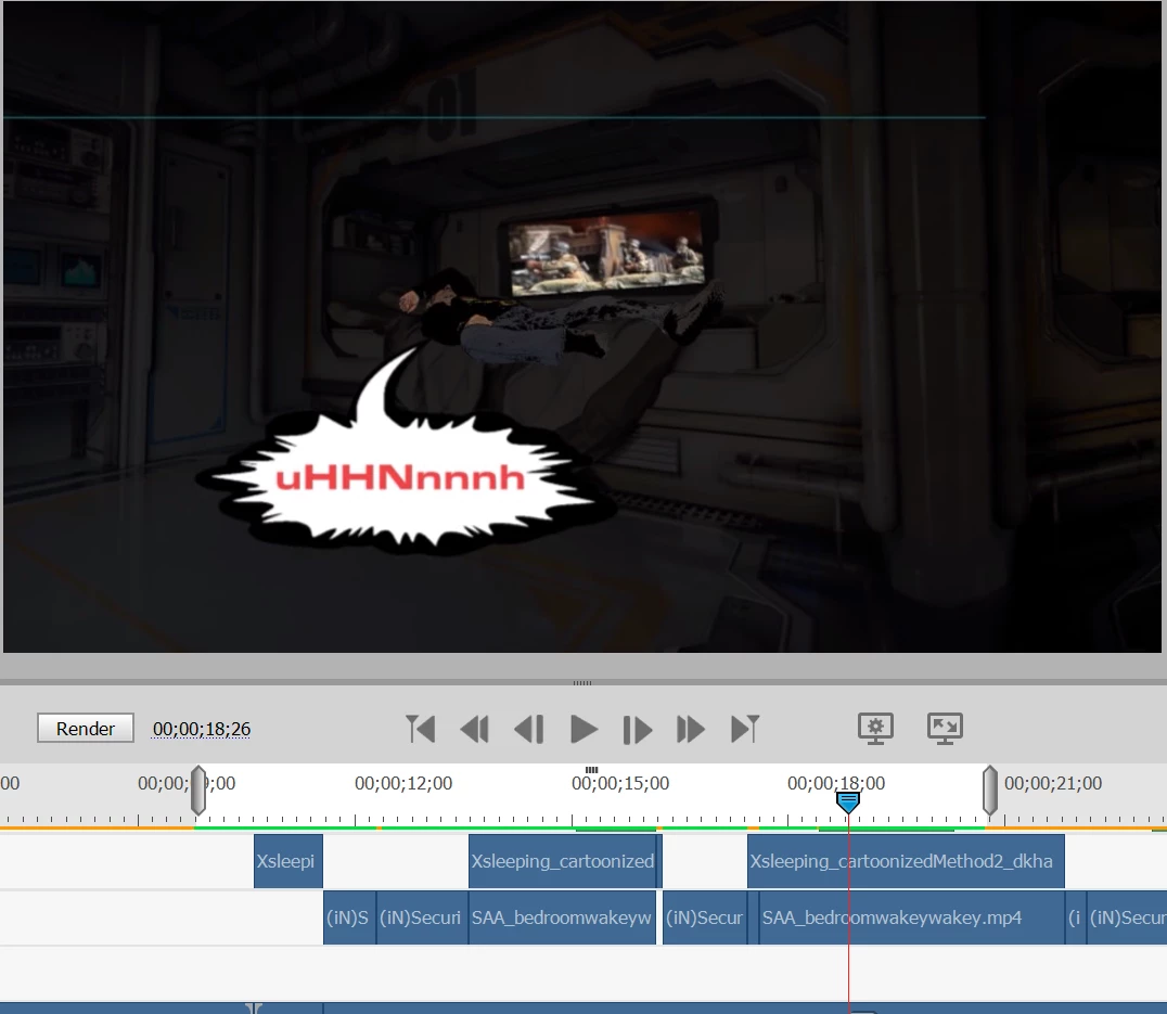

00;00;18;26 shows one of those intermittent/random line artifacts.

You can also see that the robot track is clear in the in-between frames but also fuzzy when the backdrop is fuzzy.
