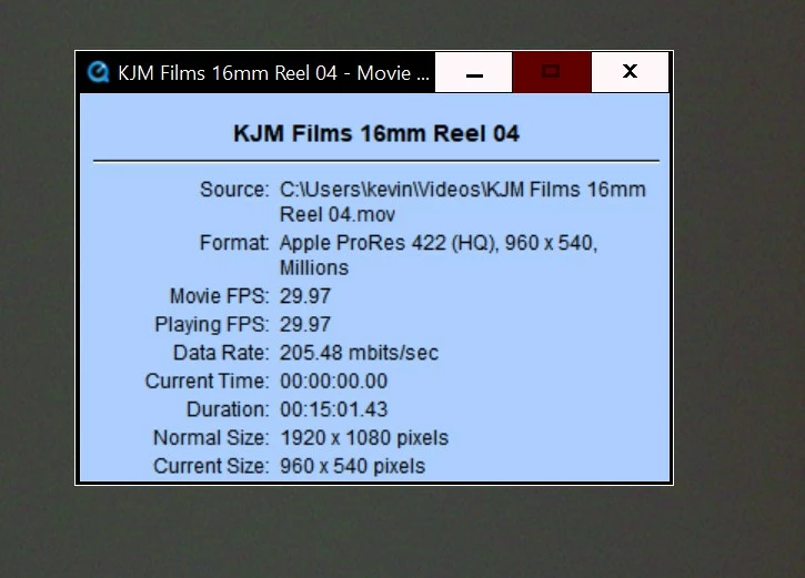

The file will open and play in Quicktime and in VirtualDub

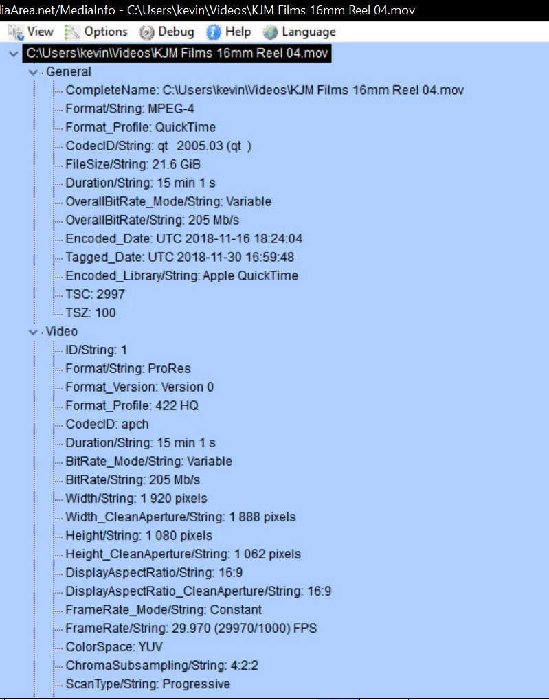

    Under video is says that the "CodecID" is "apch".  Googling for that brings that it is primarily a codec for Apple's "Final Cut Pro" editor.
    More googling about converting ProRes to MP4 suggests it can be done with the (free) Handbrake.

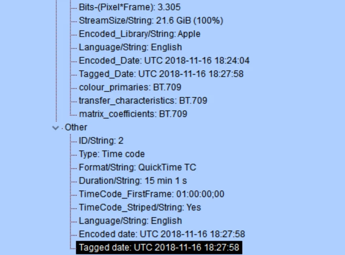

    Below is the File Data - From Quick
    time  Movie Inspector

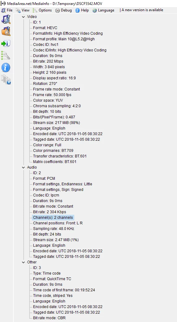

    I'm hoping for more like this:
    Jan 8, 2019 12:55 AM UTC
    Think I Got it

    "MOV" is a file "container" in video speak.  "MP4" is another container.  In the many video containers can be a wide variety of codecs.  The way to see what it is made of is to look inside a video clip file with the (free) software called MediaInfo   Install it, open a MOV file, switch to the "tree" view and post a screenshot here.
