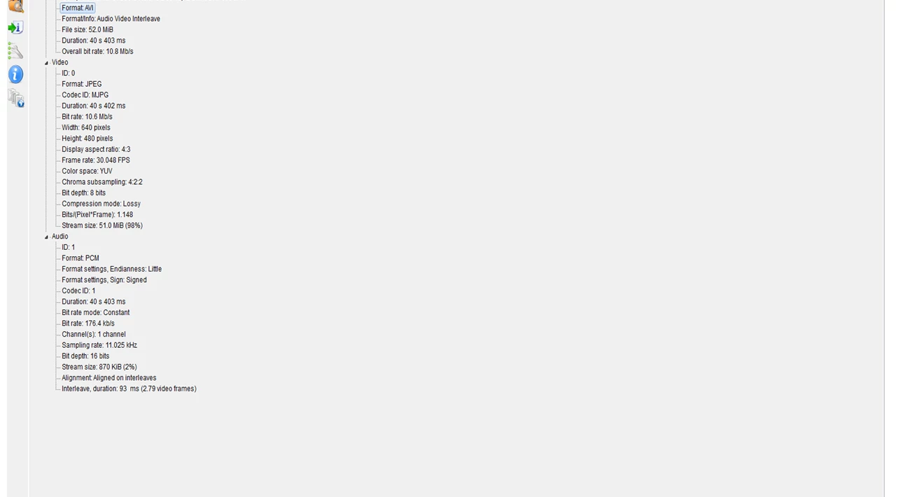

Your video is an MJPEG-AVI, a primitive video format used by some still cameras.
It's been years since I've edit MJPEGs, so I'll have to defer to another user for recommendations on how to work with it.
One option is to of course convert the file into a more editable format. But there may also be a simple way to install the codec on your computer.
Do you have Quicktime 7 installed on your computer, per the program's requirements?

Jul 4, 2017 7:20 PM UTC

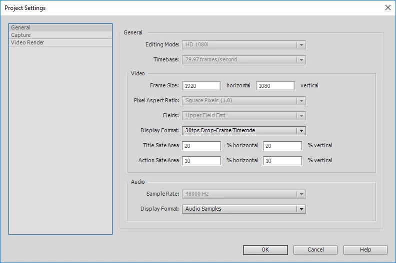

Your processor is a bit slow for running Premiere Elements -- but you may be able to do some basic editing if your project settings match your video specs. Is you say that, when you add your video to your timeline, you see a "render" line over the video before you add any effects to it, then your project is NOT set up properly, which is not allowing the program to work at its max efficiency.
For instance, I believe your camcorder shoots in 1080p, yet your project is set up for 1080i.
You still haven't told us what format your video is being saved as (AVI, MOV, MP4), but that is significant, and we won't be able to advise you how to proceed unless you can provide us that information.
In fact, even better if you download the free program MediaInfo and open a clip of your camcorder's video in it. Go to the program's View menu and set it to Tree, then copy the information is lists and pastes it to this forum. That will tell us what we'll need to know in order to advise you how to proceed.
Jul 7, 2017 11:58 PM UTC
Great recommendation about MediaInfo, because I have no idea what these things mean:
Sorry it's so tiny: I also could not quite enlarge it here.
Jul 4, 2017 1:04 PM UTC
Your 32-bit operating system is certainly going to limit your performance. But that said:
Which processor do you have with how much RAM?
What model of camcorder is your video coming from and what is the video's format and resolution?
What are your project settings, as listed under the Edit menu, under Project Settings/General?
Do you see a change if you render your timeline (press Enter) whenever you see a yellow orange "render" line above the clips on your timeline?
Jul 4, 2017 6:04 PM UTC
Hi, Steve,
I apologize in advance; I don't know what most of those words mean.
I am googling terminology. Is "processor" another word for "computer?" It's an HP...thing. Not new and not newer, but it's workin' great!
Ooh, how about this:
Processor: Intel(R) Core(TM)2 Quad CPU   Q8200 @ 2.33GHz  2.33GHz
Installed Memory (RAM): 4.00GB (3.46GB usable)
System Type: 32-bit Operating System, x-64 based processor
Pen and Touch: No Pen or Touch is available for this display
Cool! Okay, will it come out jerky if I upload it to YouTube? I can personally handle a full-screen jerky, but does the project itself needs some fixin'?
Camcorder: I have a HD 24.0 Mega Pixels 16:9 LCD Panel CMOS sensor HD output Kingear Night Vision camcorder.
And yes, there is a change in the colored line across the film, yellow, orange, green.
