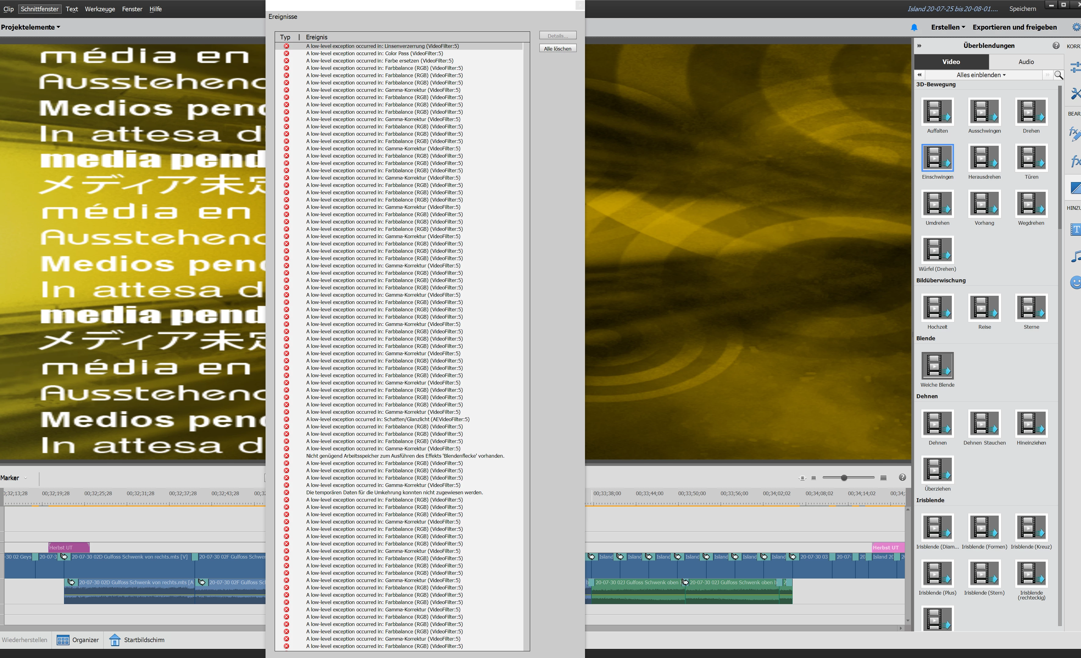

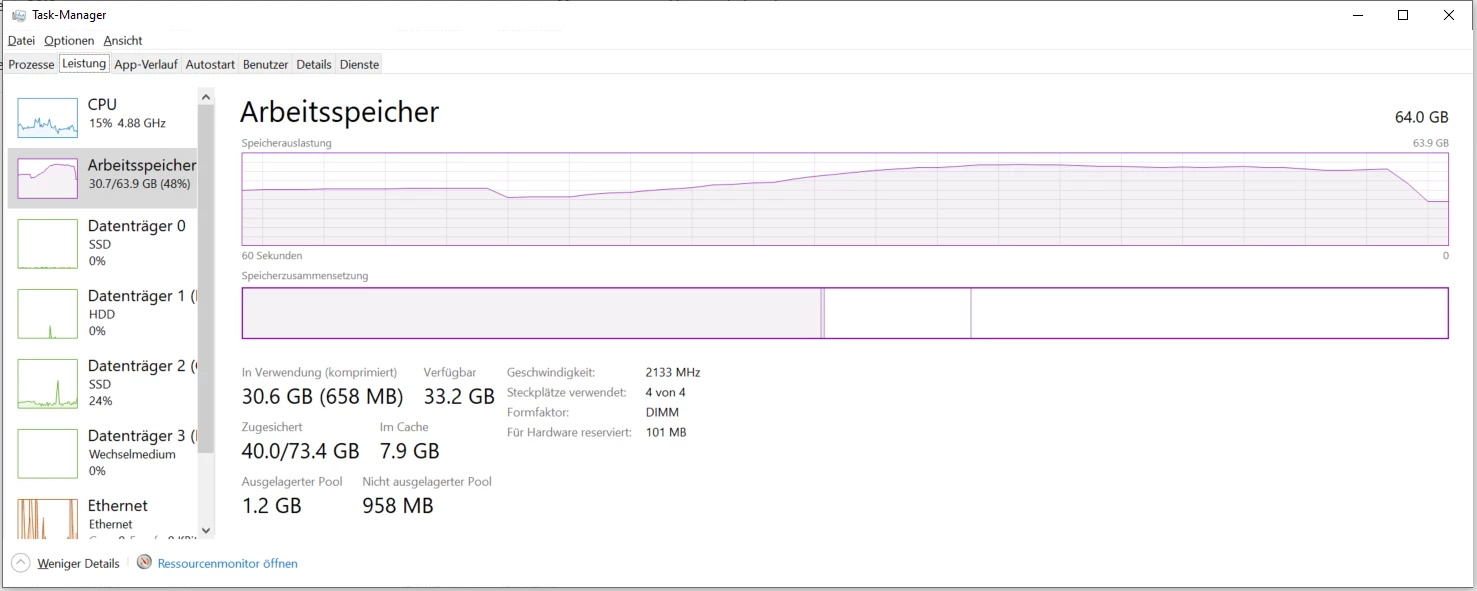

Problem: Until approx. a length of approx 50 mins everything was ok. Then first instabilities occured and now PE crashes when I try to work. Memory consumption goes up to 55GB. Various low-level exception messages caused by some videofilter (that I did not apply in that project).

- imported to test version Premiere Pro ... that crashes as well (caused by the same videofilters mentioned in the low-level exceptions)

- deleted ALL clips/photos except the very first ... no result (still uses > 30GB of memory for that 1 clip!)
