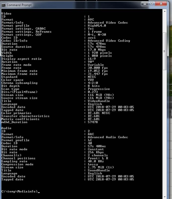

    Per Bob, it would be very helpful to know the specs of the video from your phone so that we can tell if your project settings are matching your video specs.
    When you first add video from your phone to your timeline, do you see a yellow-orange "render" line above the clip? If so, your project settings are NOT matching your video specs, and that will reduce the quality of your video and the performance of the program.
    There can be a number of reasons why the program isn't matching your video specs. But to know for sure, we'll need to know more about your video.
    Open a sample of your phone video in the free download MediaInfo. In MediaInfo, set the View to Text and then cut and paste the report it generates to this forum.
    Daknife56Author
    Aug 9, 2018 2:28 PM UTC
    Yes, the orange line is above the video. The info you requested is below:
    Peru Bob
    Aug 9, 2018 4:17 PM UTC
    I see your media is variable frame rate.  That is probably why Premiere Elements is not recognizing the true video pixel size and you have an orange line.
