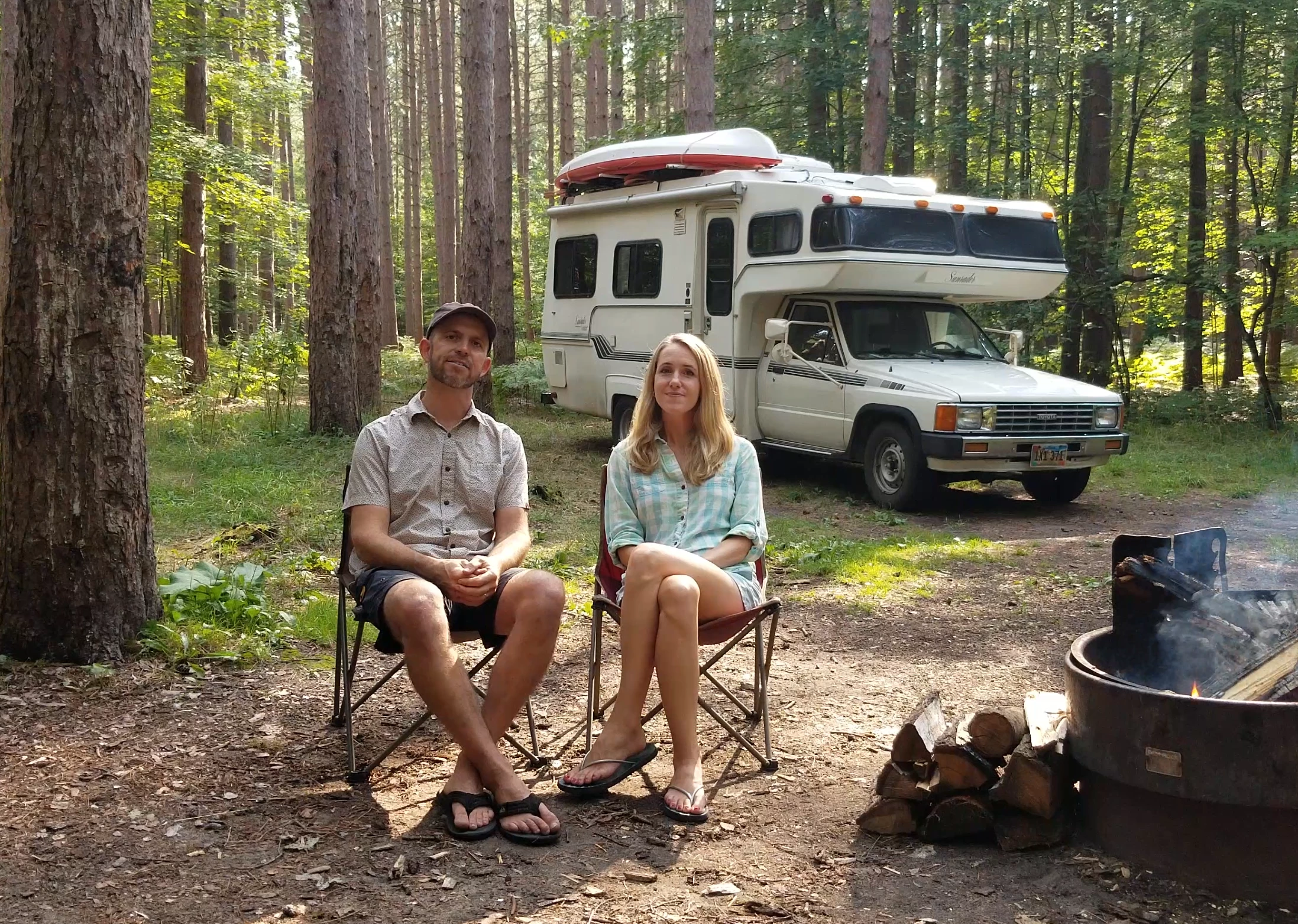

My original footage has no moire pattern showing up (screenshot before being edited in APE)

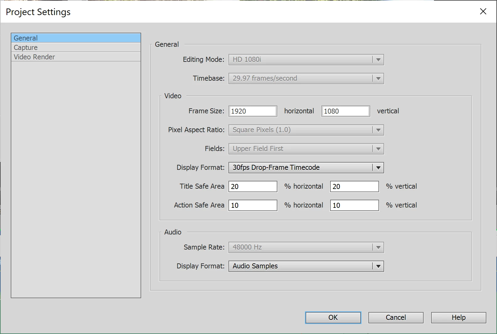

My project settings:

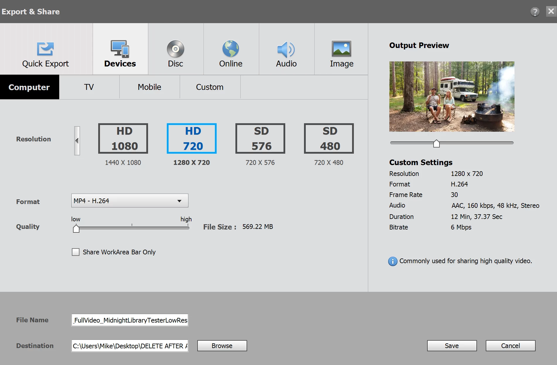

Then I export it with these settings (note, I am using the lowest settings where i feel I can still judge quality and make my final tweaks before exporting at 4k Ultra HD, which will take me about 10 hours, so I only can do that once):

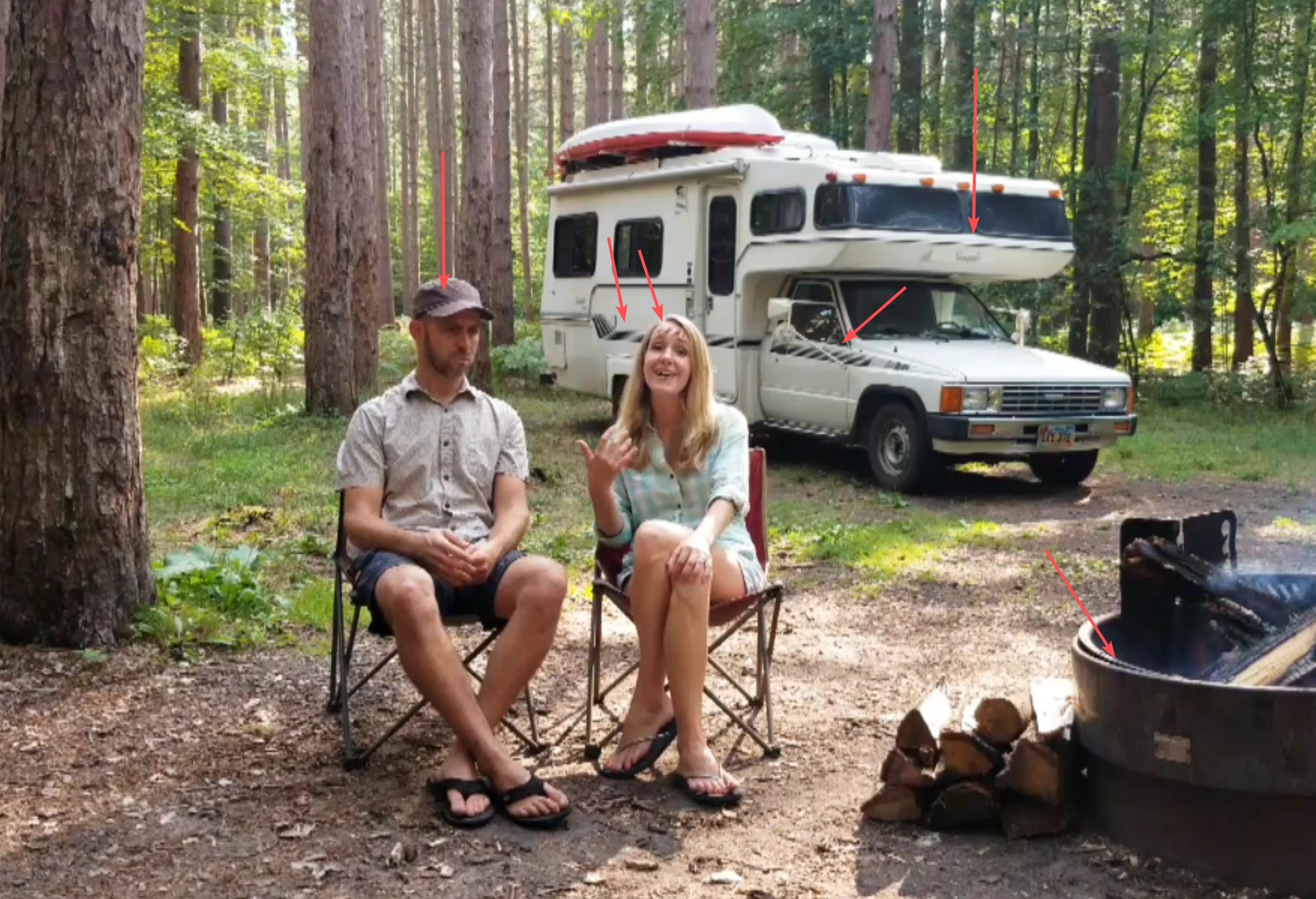

Here are the moire patterns (or banding, not sure the proper terminology for them):

Steve is the master!  That said, I will agree with him and emphasise that you have interlacing effects, not moire problems.

Well, you've clearly got a number of mismatches in your project setup which are causing this issue.
For one thing your original video is 4K and yet you're editing it as HD 1920x1080. You've also got your project set up for interlaced frames when it's more likely you're original video is progressive.
Try starting a new project and, on the New Project screen, enter Settings and select the preset for AVCHD/QFHD 16x9 29.97. (Normally the program will do this automatically, but for some reason this did not happen in your case.)
Ideally when you place your video on your timeline you will not see a yellow orange render line above the clip. An orange render line indicates that your project and video specs are not matched, and this could lead to issues like you're experiencing.
