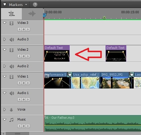

Are you working in Expert Mode?
Your video clips will be in the Video 1 row & you add text to Video 2 (or even Video 3 etc. if you staple texts).
Then you could apply Fade IN/out etc to the text as shown above.
I use PE 14.1 & previously used PE 13.1 so I suppose PE 15 will be no different.
