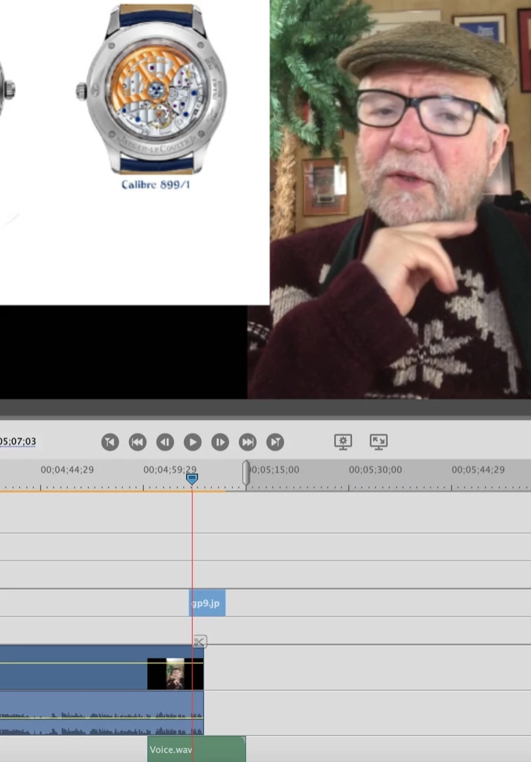

    williebegoode
    feb 4, 2019 10:21 a. m. UTC
    Richard,
    Make sure that your microphone is accessible to the narration. You will be prompted by a request to access your mic, and be sure that the mic you're using is selected by your PC as the correct one. With narration, you can have one or more other clips or none at all on the same timeline sector as the narration as illustrated:
    Traducir
