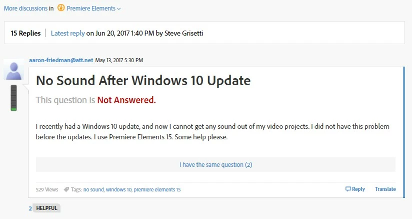

No Sound After Windows 10 Update
I recently had a Windows 10 update, and now I cannot get any sound out of my video projects. I did not have this problem before the updates. I use Premiere Elements 15. Some help please.

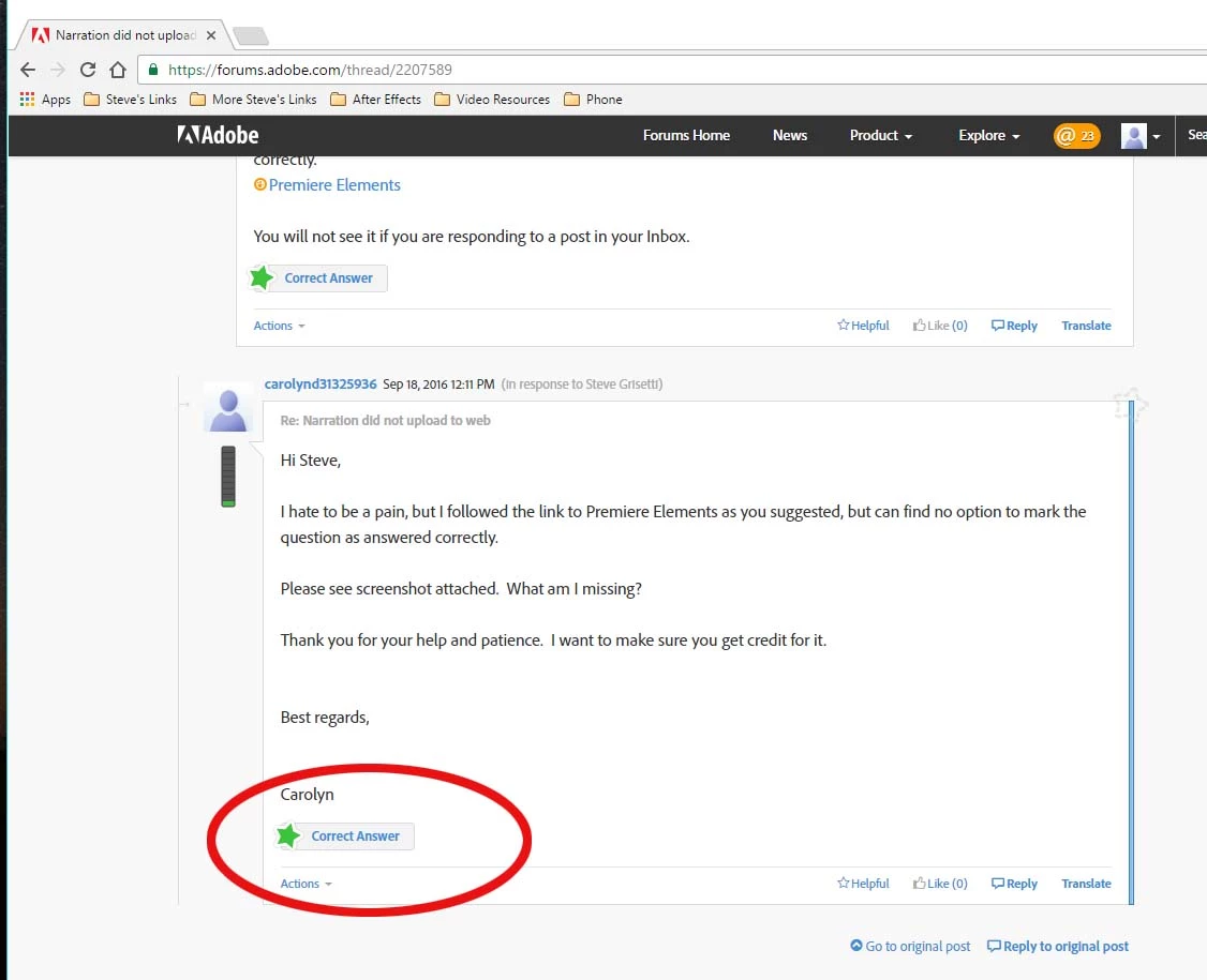

If you're on the forum, you'll see something like this.
June 21, 2017
Sorry Steve, I am on the forum and just don't see that option in my web browser. "Google Chrome" Here is a graphic of the original Q
And here is a graphic of the answer that showed me the way.
I would love to help, but as I see it.... this choice is missing... sorry
June 20, 2017
Please mark this question correctly answered, tnh.
June 20, 2017
Steve G, I've marked helpful and liked....but see no link and or icon for the word "correct"

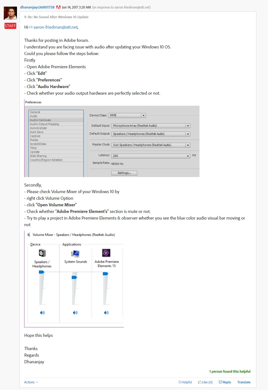

Hi aaron-friedman@att.net,
Thanks for posting in Adobe forum.
I understand you are facing issue with audio after updating your Windows 10 OS.
Could you please follow the steps below:

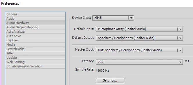

Firstly
- Open Adobe Premiere Elements
- Click "Edit"
- Click "Preferences"
- Click "Audio Hardware"
- Check whether your audio output hardware are perfectly selected or not.
Secondly,

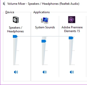

- Please check Volume Mixer of your Windows 10 by
- right click Volume Option
- click "Open Volume Mixer"
- Check whether "Adobe Premiere Element's" section is mute or not.
- Try to play a project in Adobe Premiere Elements & observer whether you see the blue color audio visual bar moving or not
Hope this helps
Thanks
Regards
Dhananjay

It appears that the rollout of the "Windows 10 Creators" update may cause a problem.  My use of Premier Elements 15 has been very stable with no issues for months.   This morning, my ASUS laptop computer did the update this morning.  It is much bigger and takes a lot longer than the usual monthly updates.
Checking Premier Elements 15, I found it was silent.  Using the suggestion above from Dhananjay, I checked the Audio Hardware preferences.  Default Input was "None".  My choices are different than the above suggestions.  The only choice besides "None" is "Microphone (VIA HD Audio".  Picking that fixed it.

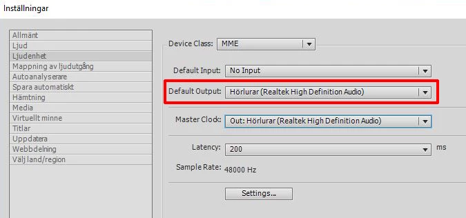

torbjörnh73997573
June 22, 2017
Thank you!
This fixed my problem. (Swedish)
