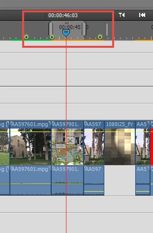

    To do that, you'll need to set the Work Area Bar over each short segment and then, on the Publish & Share tab, set each output to Output Work Area Bar Only.

    I looked there, but it is for the output of the whole film? I look for export of the clips one by one, because I edited all the clips.

    Dat bedoel ik met Work Area Bar.
    Die moet je over een clip plaatsen en in de export settings aanvinken.

    You can save every clip as mp4 but you have to export one at a time, by placing the work area bar over a clip.
