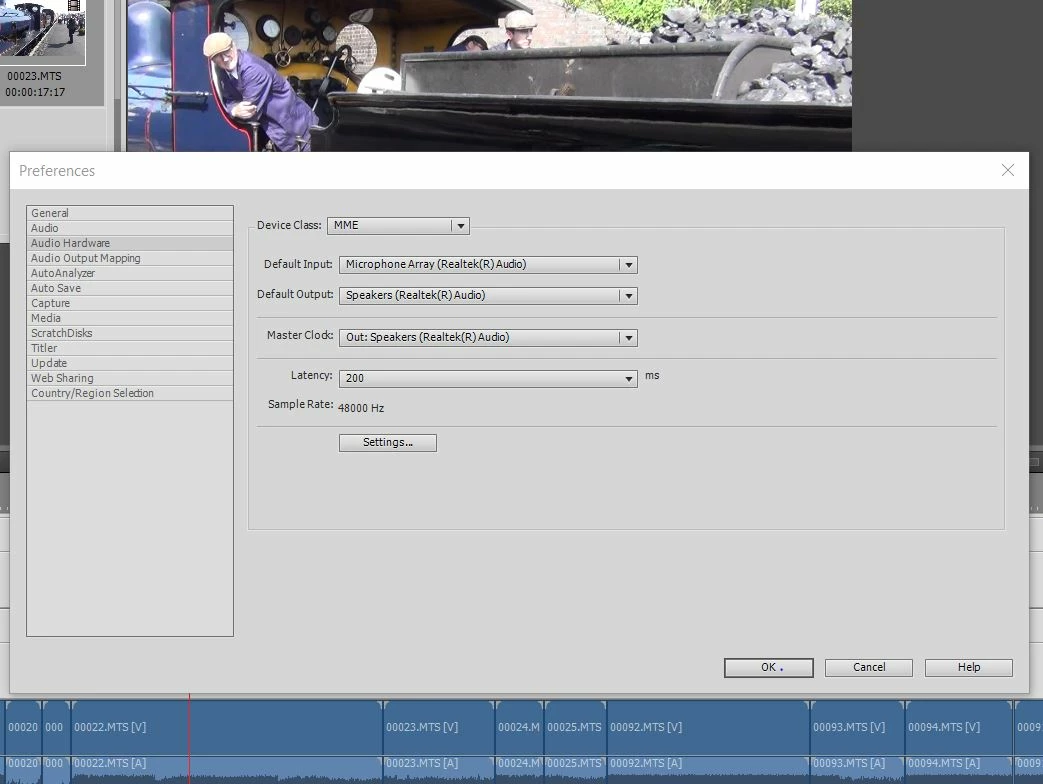

robinp33978336
Jan 18, 2019 5:44 PM UTC
I had many problems with the installation of PREL 2018 on a new laptop with Windows 10, and noticed the same 'speakers not working' in preferences/audio hardware.
I found a solution by opening Windows Settings/ Privacy / Microphone and making  sure the microphone access is 'On', and that it is 'On' for the camera.
This solved all the problems I was having with the program hanging, crashing, not closing etc, as well as restoring sound.
This is how your settings should look.
And the PREL Preferences should look like this:

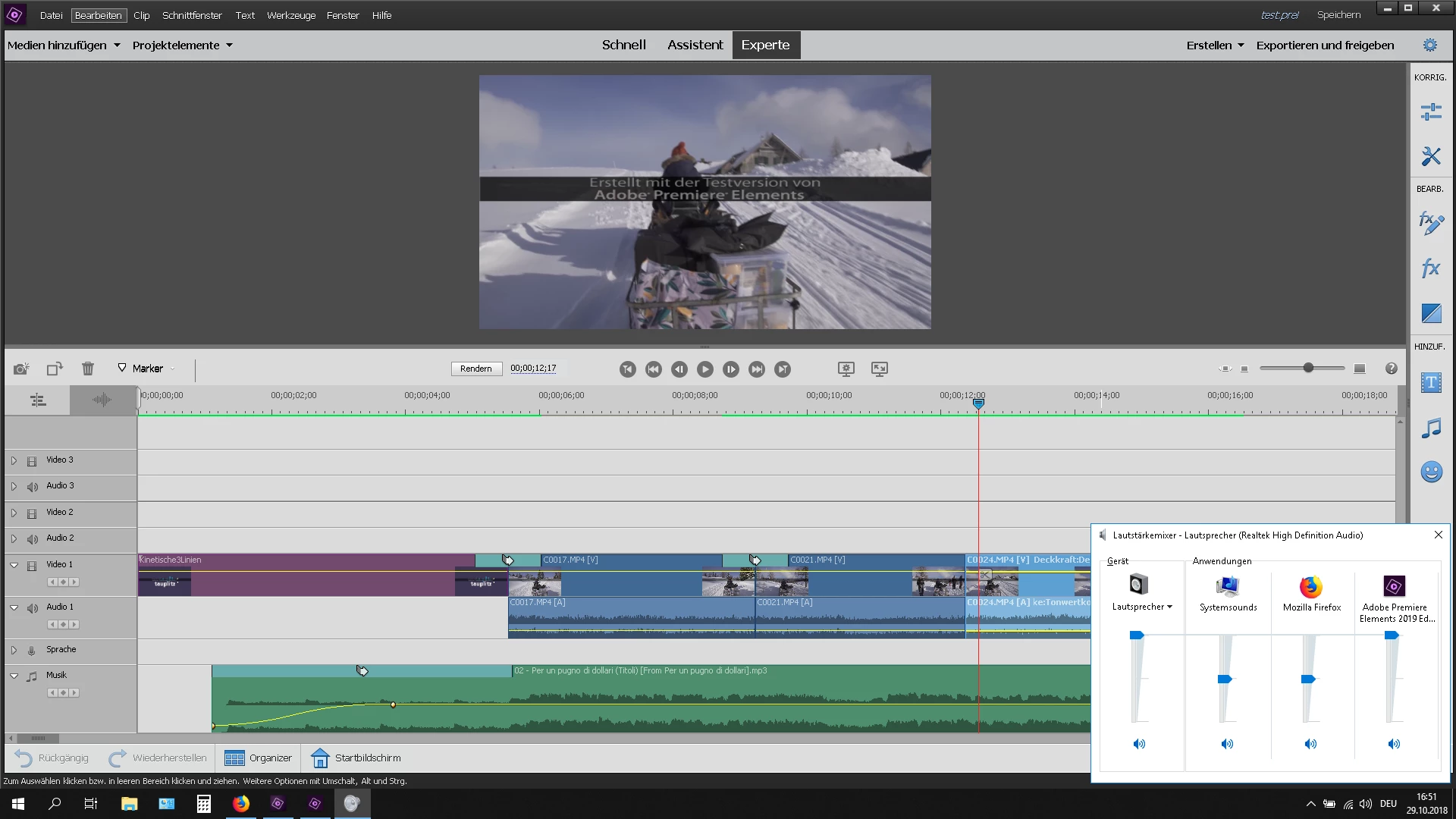

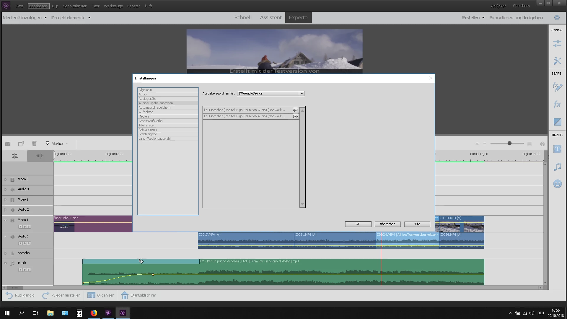

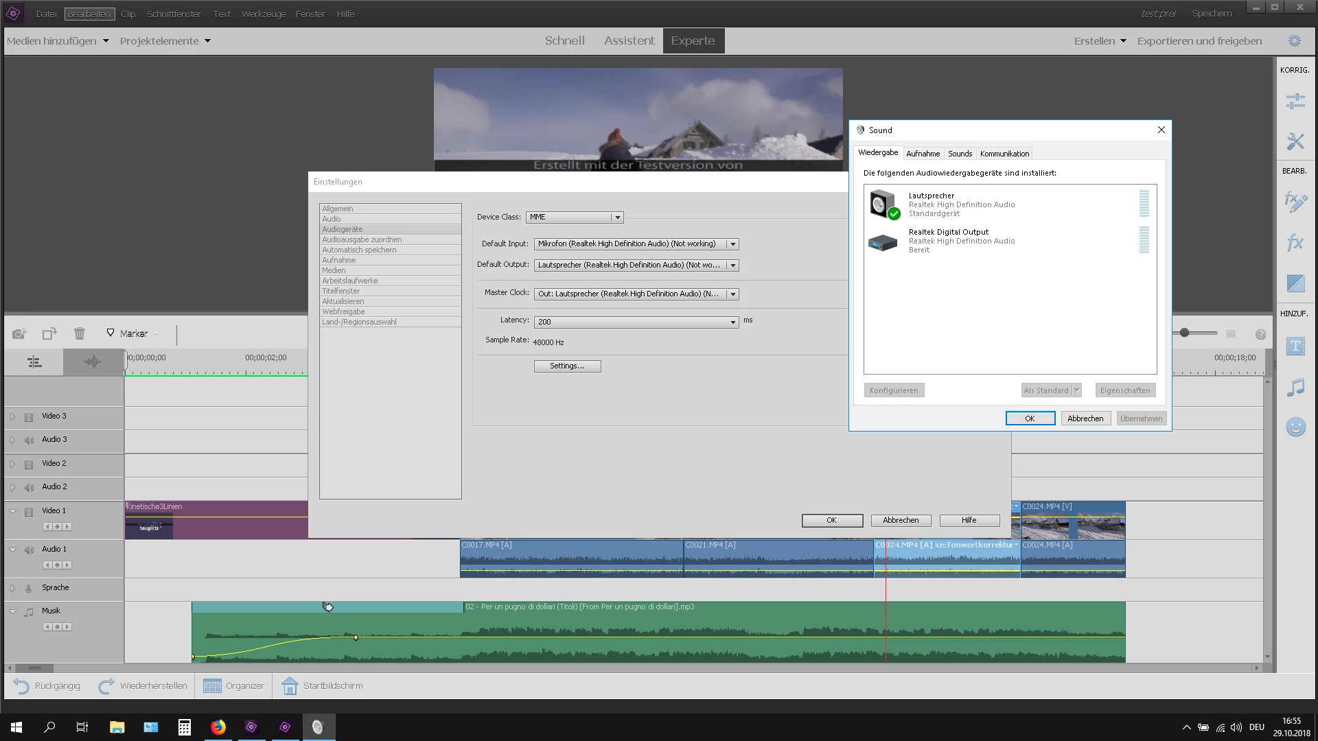

HelmutWR
HelmutWRAuthor
Oct 29, 2018 4:03 PM UTC
I checked that as well - see screenshots. Everything as it should be. When I try to change In/Out settings in PE I get an error message - MME device error.
