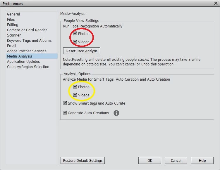

Nov 22, 2020 6:32 PM UTC
Thanks Steve - that is very well hidden & not at all intuitive!
The idea that an setting in the organizer would affect the video editor is not obvious.
o
You would disable the 4 items here?

Nov 22, 2020 8:36 AM UTC
That sounds just like what I need.
However in PE 2021 I do not see "AutoAnalyzer" under Edit / Preferences & so far have not found itz elsewhere.  The online help for Pan & Zoom shows how to set "Hold" to zero but does not mention any AutoAnalyzer option.
Nov 22, 2020 1:50 PM UTC
That is correct. Since I made this tutorial Adobe has removed this setting. A similar setting can be found, however, in the Organizer's preferences.
Nov 22, 2020 1:56 AM UTC
Nope. Adobe made the decision a few generations ago to make the tool more automatic. Much to the detriment of the tool.
I've created a tutorial that shows you how to work around some of those settings.
