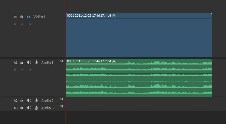

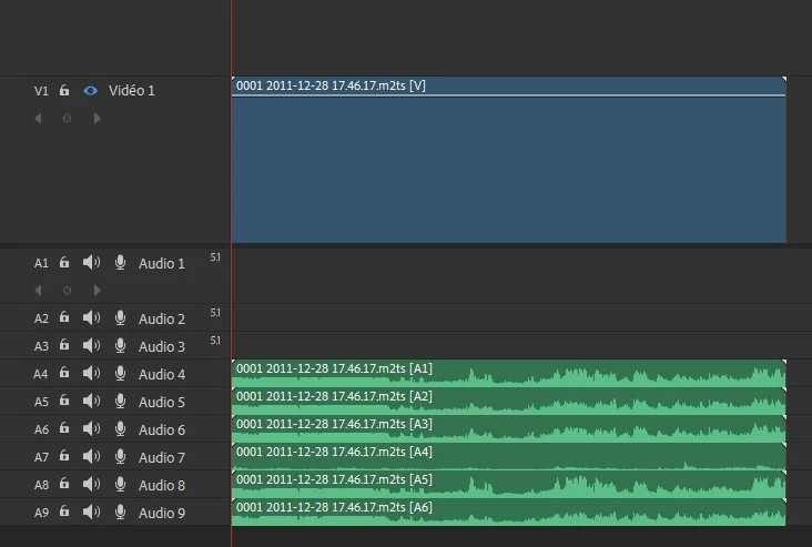

I'm fairly sure that this is a bug, I'm not sure if this is the proper place to report it though.
Here's what happens:
- I have M2TS video files (Sony camcorder), full 1080i 25 fps video with 5.1 audio channels.
- I create a project with the PAL full 1080i HD / 5.1 audio preconfig. The program creates 3 video channels, and 3 5.1 audio channels
- When I import an M2TS clip to Video 1, PE2025 systematically says that the format is different from the project, do I want to conform it, etc.
- Regardless of the choice I make, the program will then create 6 additional audio channels, one for each of the clip, import the audio in them, AND leave the initial 3 5.1 channels it created empty.
The only way to circumvent this, is to convert the files to MP4 with the same settings (and highest possible quality!). Then they are recognized properly, all the audio going to the Audio 1 channel subdivided in 6 sub-channels.
The 1st screen cap is how it looks with an M2TS clip, and the second one is with the same file converted to MP4, the way it's supposed to work.

Ann Bens
Apr 15, 2025 10:30 AM UTC
This is a long-standing issue.
Elements interpreters the file as 6 mono tracks instead of one.
Elements does not allow you to modify the audio channels.
erpol
erpolAuthor
Apr 15, 2025 1:25 PM UTC
Well, at least it works with MP4, so it's a minor hassle - I just need to make a note so I know in 5 years why on earth I converted all those files !
As it is, the M2TS are unworkable, as you can't do any global audio treatment (fade ins or out, volume etc) with 6 discrete channels!
