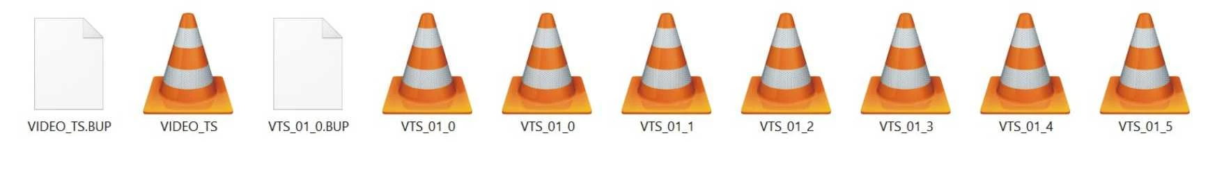

Here are the files in the VIDEO_TS Folder of the project that is not working correctly, as seen in Windows 10 File Explorer.

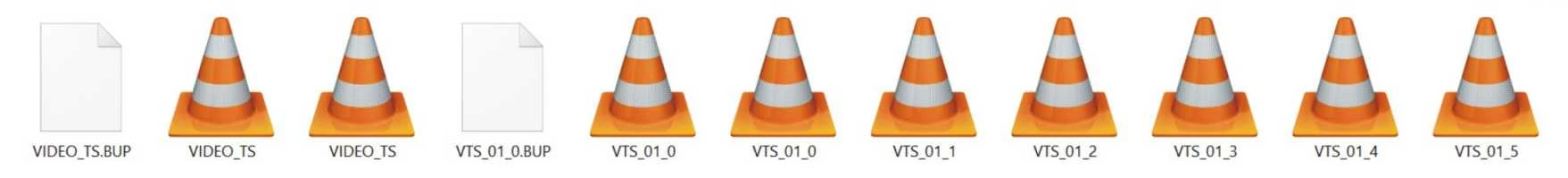

Here are the files in a VIDEO_TS Folder for a project that VLC plays correctly.
They both have a "VLC media file (.ifo) (.IFO)" VIDEO_TS file but the non-working project is missing the accompanying "VLC media file (.vob) (.VOB)" VIDEO_TS file.
