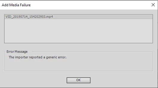

PEL 15 Media Import Generic Error
I am trying to import some videos from my MotoG6 phone which are mp4 format. Some import without any problem while a couple always cause PEL15 to report a generic error - screenshot of error report below. Any thoughts as to why this may be happening?

    Jul 15, 2019 1:18 PM UTC
    Most likely the issue is that your video uses variable frame rate compression. Version 2019 can work with variable frame rate video, but earlier versions can have an issue with it.
    The easiest solution (short of upgrading to the current version of the program) is to convert the video using the frame download Handbrake. My tutorial shows you the hows and whys.
    Converting videos with Handbrake - YouTube

    bobsapeyAuthor
    Jul 15, 2019 1:32 PM UTC
    Hi Steve, thanks very much for that, it has made my phone much more useful than I thought it was.

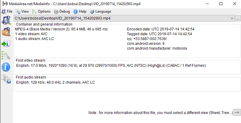

    Jul 15, 2019 12:02 PM UTC
    I'm not sure what's up, since I edit Moto 6 video all the time. Although I guess it depends on which software you're using to shoot your video on your phone.
    Open one of your MP4s in the free download MediaInfo. In MediaInfo, set View to Text and then copy the report that is generated and paste it to this forum. Once we know the specs of the video you're trying to import we can more likely help you.

    bobsapeyAuthor

    General
    Complete name                            : C:\Users\bobsa\Desktop\VID_20190714_154202903.mp4
    Format                                   : MPEG-4
    Format profile                           : Base Media / Version 2
    Codec ID                                 : mp42 (isom/mp42)
    File size                                : 95.4 MiB
    Duration                                 : 46 s 685 ms
    Overall bit rate                         : 17.1 Mb/s
    Encoded date                             : UTC 2019-07-14 14:42:54
    Tagged date                              : UTC 2019-07-14 14:42:54
    xyz                                      : +53.5887-002.7636/
    com.android.version                      : 9
    com.android.manufacturer                 : motorola
    com.android.model                        : moto g(6)
    Video
    Format                                   : AVC
    Format/Info                              : Advanced Video Codec
    Format profile                           : High@L4
    Format settings                          : CABAC / 1 Ref Frames
    Format settings, CABAC                   : Yes
    Format settings, Reference frames        : 1 frame
    Format settings, GOP                     : M=1, N=30
    Codec ID                                 : avc1
    Codec ID/Info                            : Advanced Video Coding
    Duration                                 : 46 s 560 ms
    Bit rate                                 : 17.0 Mb/s
    Width                                    : 1 920 pixels
    Height                                   : 1 080 pixels
    Display aspect ratio                     : 16:9
    Rotation                                 : 180°
    Frame rate mode                          : Variable
    Frame rate                               : 29.970 (29970/1000) FPS
    Minimum frame rate                       : 15.018 FPS
    Maximum frame rate                       : 43.103 FPS
    Standard                                 : NTSC
    Color space                              : YUV
    Chroma subsampling                       : 4:2:0
    Bit depth                                : 8 bits
    Scan type                                : Progressive
    Bits/(Pixel*Frame)                       : 0.273
    Stream size                              : 94.3 MiB (99%)
    Title                                    : VideoHandle
    Language                                 : English
    Color range                              : Full
    Color primaries                          : BT.601 NTSC
    Transfer characteristics                 : BT.601
    Matrix coefficients                      : BT.601
    mdhd_Duration                            : 46560
    Codec configuration box                  : avcC
    Audio
    Format                                   : AAC LC
    Format/Info                              : Advanced Audio Codec Low Complexity
    Codec ID                                 : mp4a-40-2
    Duration_FirstFrame                      : 29 ms
    Bit rate mode                            : Constant
    Bit rate                                 : 128 kb/s
    Channel(s)                               : 2 channels
    Channel layout                           : L R
    Sampling rate                            : 48.0 kHz
    Frame rate                               : 46.875 FPS (1024 SPF)
    Compression mode                         : Lossy
    Stream size                              : 729 KiB (1%)
    Title                                    : SoundHandle
    Language                                 : English
