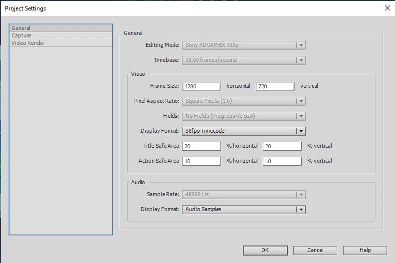

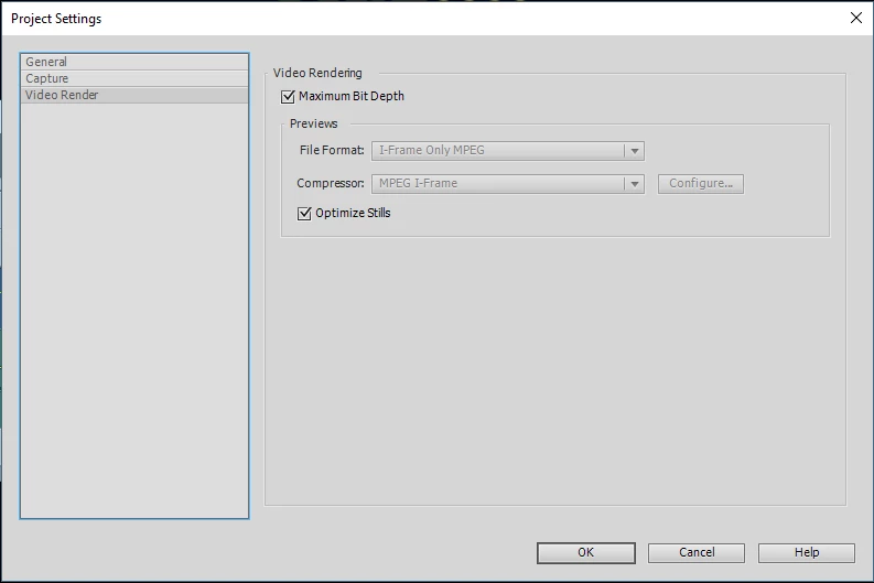

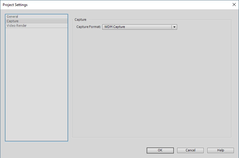

Yes, I looked on these forums and saw similar issues but none of the solutions work for me.
I have been having this issue for a while. Sometimes it works fine and plays back smoothly, sometimes it pauses ever second during playback.
Moving clips to same SSD didn't work. I've even doing a project with a single file as to not mix formats and settings and its having the same issue.
Disabling hardware rendering did not work.
Changing Audio hardware did nothing.
I have a duel monitor setup, I've tried single monitor. Still nothing.
I'm guessing its the issue with something stealing priority from the application, but I have shut everything down and it still does not work.
I just downloaded and installed this app not 2 months ago, it should be up to date. I would like to keep using it but If I can't I need to find a different app.
Please help.
