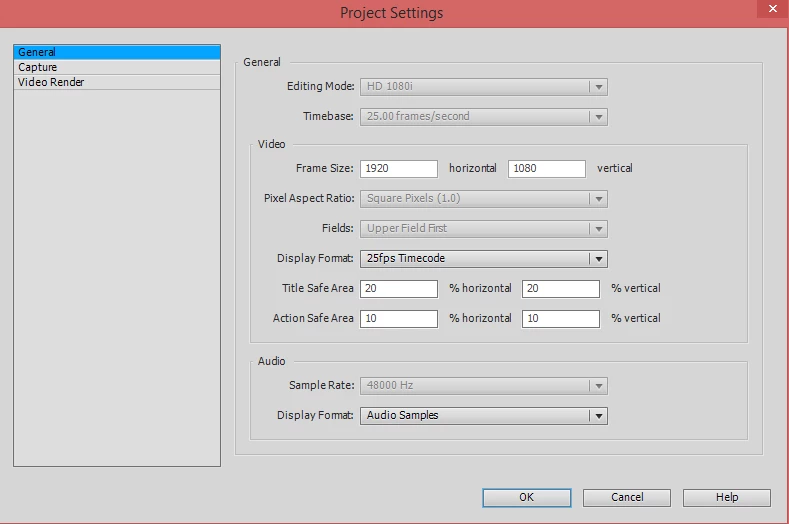

I have been using PSE 12 for the past few years and finally upgraded to PSE 15. On my first project I uploaded my videos into my project and applied them to the timeline. On playback they stop and stick and then start again so only showing a couple of frames in the video.  So they dont play smooth. I then put the same videos into PSE 12 and they played back beautifully?
The videos are MP4 files and are from my Sony Cybershot HX20V. But they work fine in PSE 12 so it may be a set up issue in PSE 15?

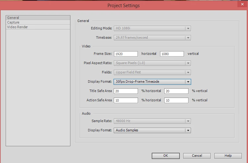

My project settings are here in PSE 15
And this is the setting for the video itself?
This below is the settings in PSE 12 which work fine ?
The only thing I can see is the 25fps in PSE12 and 30 in PSE 15? I changed the setting to Frame but that didnt do any good

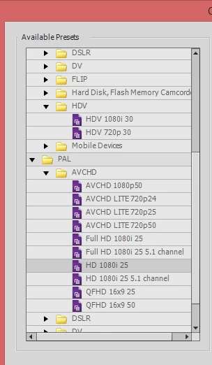

    Dec 29, 2016 1:27 PM UTC

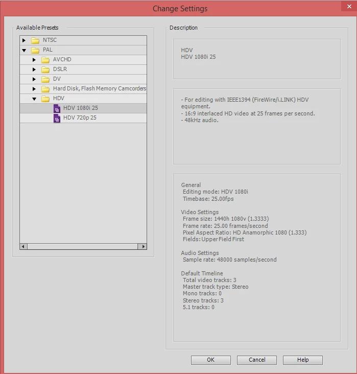

    No, Jilly. But you're getting closer.
    Look under PAL/AVCHD and select the HD 1080i 25 option.
    Dec 29, 2016 7:29 PM UTC
    Hi Steve
    Thanks for getting back to me

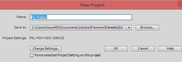

    So I have gone back in and changed the settings to the below?
    Hope this is correct?
    So now it is showing the below settings and I have ticked the Force selected Project setting on this project>
    So I have loaded one of the videos that I originally used (which was jerky and jumpy)
    There is no yellow/orange line and it also playing back without any jumps!! Yey!!
    Hope I have done everything I need to do now Steve?

    Since you are in the UK, you are on the PAL TV system rather than the NTSC system.
    And now that I know that, you should be using the PAL presets, rather than the NTSC.
    Start a new project and, from the Settings, select the preset for PAL HD 1080i, which should show as 1440x1080 25 fps -- which will match your video specs.
    I'm not sure why your program is defaulting to NTSC settings. It should know that you are using the European TV standard, based on the country you selected when you installed the program. But that fact may be at the source of some of your problems.

    Would it be this one below?
    I just cant see one that just says HD?

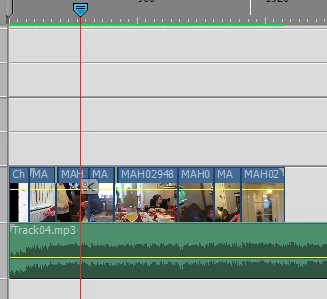

    Dec 29, 2016 9:32 AM UTC
    Hi Steve
    I have just put my video onto my timeline and I have no yellow line?
    So now my settings show as the below
    Have I done this correct and should this work ok now?
    I have tried a video and its not jumpy?

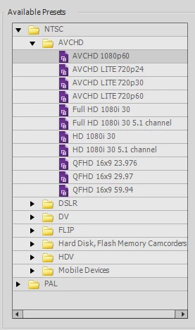

    Dec 27, 2016 8:01 PM UTC
    Since you are seeing the yellow render line, your project is not setting up properly to match your video specs for some reason. Try doing it manually.
    Start a new project. On the New Project panel, click Settings and, for your video, select preset for AVCHD/HD 1080 (1440x1080) and click OK. Back on the New Project panel, check the option to Force Settings and then start your new project.
    When you add your video to the beginning of this timeline, you should NOT see a yellow-orange render line above the video.
    If you do see this render line, we will need more complete specs on your video. We may also need you to open one of your video files in the program Media Info so we can see what it's really made of.

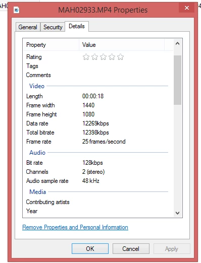

    BTW, are you editing NTSC or PAL video? That difference between 25 fps and 30 fps in version 12 and 15 is very significant!

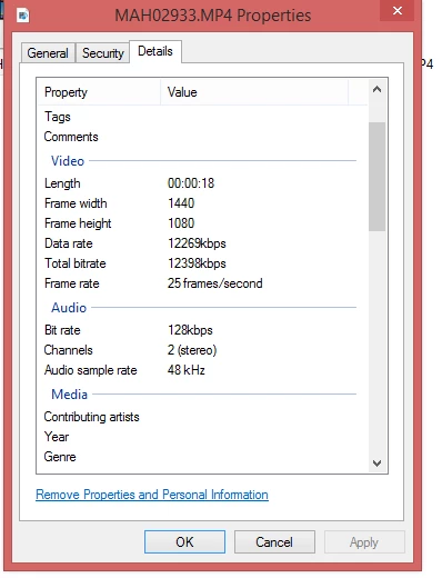

    Dec 28, 2016 10:18 AM UTC
    Good morning Steve
    The settings show as the below currently
    And my videos are showing as the below

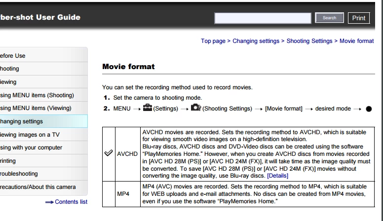

    You asked me to change to AVCHD/HD 1080 (1440x1080) but I can see 4 different ones?
    So I wasnt sure which one to go to as even on my camera settings it doesnt really match up with one?
    So I went with the HD 1080i 30 to check and I do see the orange/yellow line still?
    Within my camera setting it says I am shooting in MP4 25 but there is an option to shoot in AVCHD  1080 50i / 50p
    Hope I have put enough info down for you Steve?

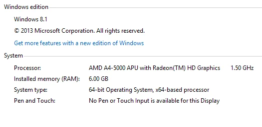

    Dec 26, 2016 10:43 PM UTC
    Are you sure you're editing video in PSE 15 (Photoshop Elements)? More likely you're editing in PRE 15 (Premiere Elements).
    In any event, it's clear from your screen shots that your project settings are not matching your video specs.
    You also seem to be using a pretty old computer. What processor does that computer have and with how much RAM?
    Have you manually gone to Windows Update and ensured you have all of the latest updates, including non-critical updates for your system's drivers?
    Finally, when you first add a video the beginning of your timeline, do you see a yellow-orange "render" line above the clip? This is an indication of a mismatch between your projects settings and video specs, which could well account for your playback problems.
    Dec 27, 2016 3:44 PM UTC
    Good afternoon
    I do get the yellow render line. It is green as it has been rendered.
    My PC is only three years old and has Windows 8.1?
    This is the settings

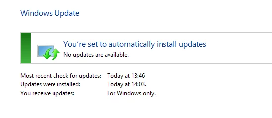

    And with the updates none are available
    Look forward to hearing from you
    Jilly Lowe
