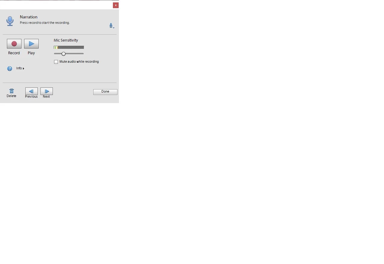

Okay, all of you who may be interested. After my original post re disappearing sound on a Premiere Elements project, several replied with various suggestions, none of which worked. My solution that time was to simply begin the whole project over again. Well, it happened again on a different, much larger project and I didn't really want to spend days rebuilding it. So in a last ditch effort before having to do that, I simply began clicking and reading no matter irrelevant the menu item sounded. So, here is the solution to my problem of sound suddenly not working on a project:
1. In the menu bar at the very top of the screen, click on Tools, then Narration and the box/window below will open.
2. Note below the slide the tiny box labeled "Mute audio while recording".
3. If that box is checked, then UNCHECK IT.
4. Now try running/playing your project and see if the sound works. In my case it did. How or why that little box got checked is a mystery to me. I never used Narration in the project. All narration was done in Photoshop when I made the slideshow. After moving it to Premiere, no recording was done. Is the checked box the default setting? I have no idea. If so, then why did my project have sound for several working sessions, but then suddenly have none? Again, I have no clue. Digital gremlins I guess. At any rate, thank those of you who tried to help me. Keep this in mind for legacy users who may have the same problem. This solution may work for them.

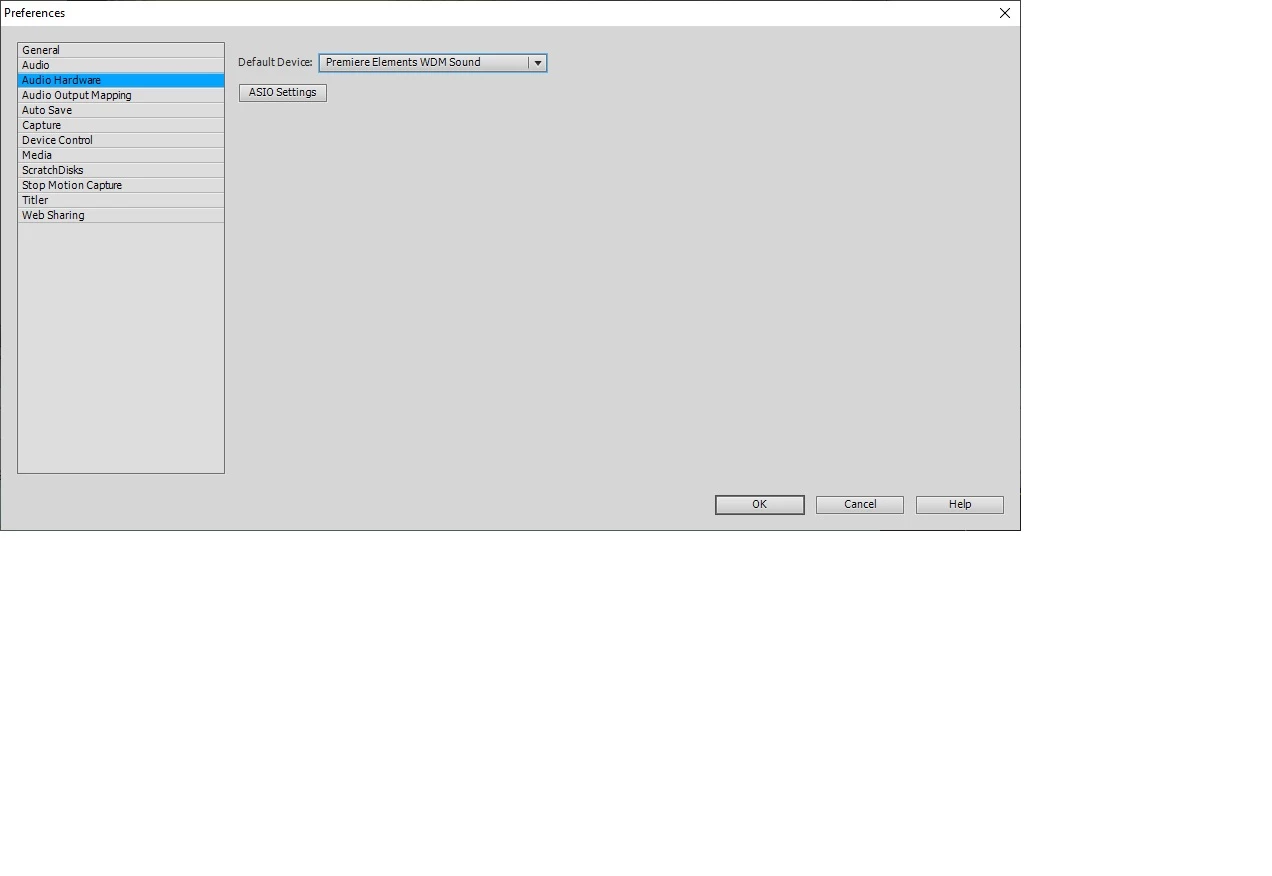

Jul 8, 2019 3:27 PM UTC
Have you tried going to the program's preferences (under the Edit menu on a PC) and, on the Audio Hardware page, switching around some of the input and output settings?
These settings can be reconfigured by something as simple as plugging a USB microphone into your computer.
If you see audio waveforms on your timeline but don't hear them playing, most often it's an Audio Hardware setting.
JRAYnSCAuthor
Jul 8, 2019 5:27 PM UTC
I have looked at the audio hardware setting in Premiere, but have not tried changing anything since every other program on my PC works fine, and because other projects in Premiere play normally. But, as you say, it's worth a try, so I will before the day is out and let you know. Thank you for all suggestions and willingness to help.
JRAYnSCAuthor
Jul 8, 2019 8:44 PM UTC
When I go to Preferences and look at Audio, Audio Hardware, and Audio Output Mapping, there are NO choices there; only what they are set to. When I press the dropdown arrow, all it shows is what is selected in each category.

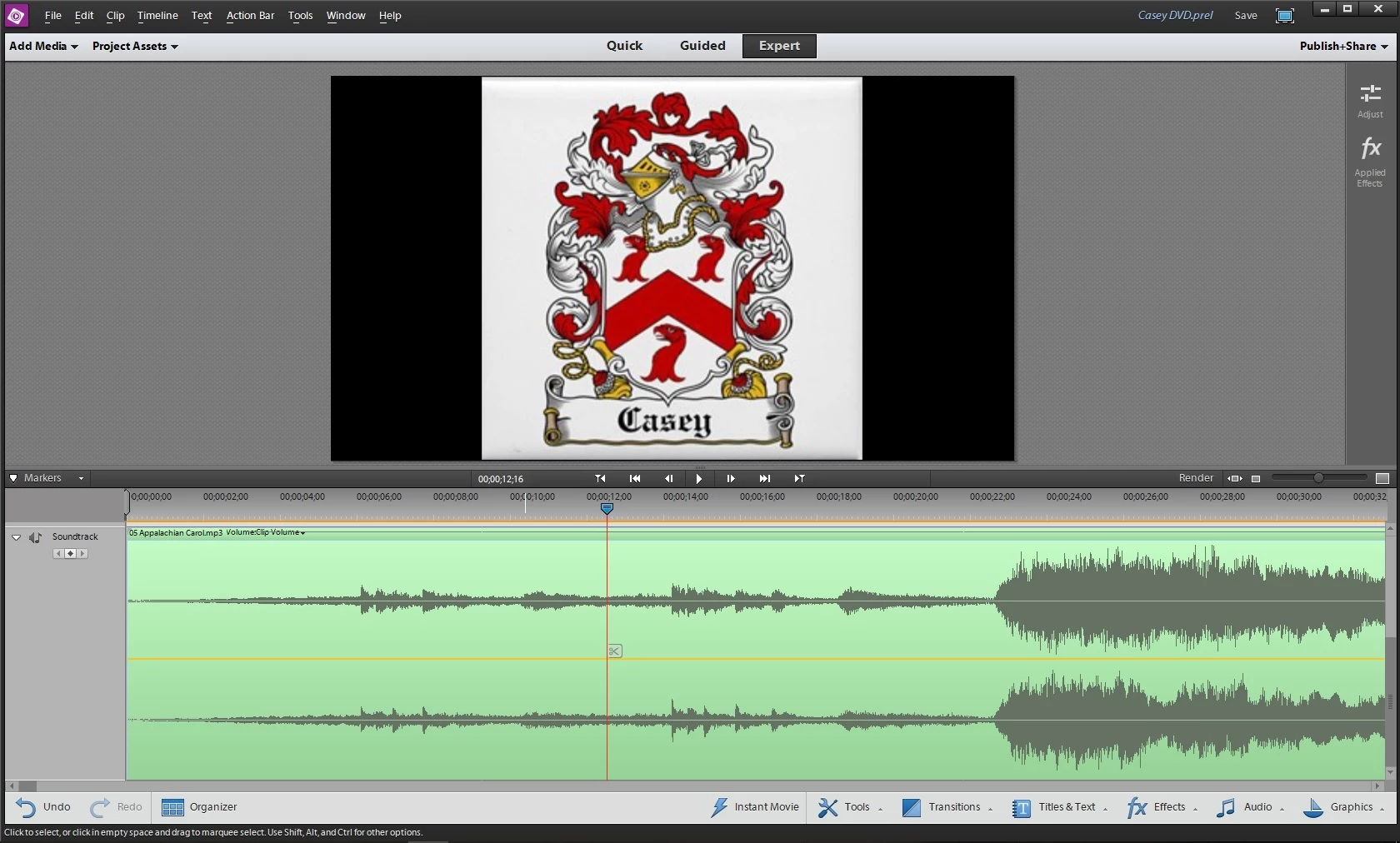

Jul 8, 2019 12:00 PM UTC
Your screen shots indicate a very very low audio level -- almost non-existent. Try right-clicking on one of the audio tracks and selecting Clip/Normalize and see if you can hear it better.
If you even after normalizing the audio you still can't hear anything, then it's definitely a preference setting.
JRAYnSCAuthor
Jul 8, 2019 2:12 PM UTC
Thank you for that suggestion. I did "Normalize" the sound track and the wave form is now very visible, but it still does not play in this project. Strange, since others work fine, which shows that it is not the PC or the Sound Card, etc. I have checked Preferences and cannot see a way to silence the playback. Any idea what may be keeping it from playing audio? You said in your first reply that the sound must have been very low. This sound track is background playing under/behind the main audio track, which is someone speaking, so I had adjusted both tracks to make the speaking voice dominant and music softer.

Jul 6, 2019 12:54 AM UTC
Can you post a screen shot of your timeline?
Do you see a waveform on the audio track? If so, it's most likely a setting in your preferences needs to be changed.
JRAYnSCAuthor
Jul 6, 2019 1:28 PM UTC
I do not see a "wave form" (if by that you mean an irregular line like on a meter), but I do the solid continuous green or orange line (I can't recall the color--it is on my wife's machine and I am now on my own machine). As stated in the original email, with the line I see and which has not changed, this project played perfectly for several days as we perfected it. It was working fine the last time I shut it down on July 3. But when I opened the project on July 5 to work some more, the sound did not play. Yes, the audio indication line and all files were still exactly where I left them on July 3. I ran trouble shooter on my PC and all is well. Sound card works perfectly. As stated, even a different project in the same program on same PC plays fine. Strange.
As for taking a screen shot, as stated I do email, etc. on my PC and the project is on my wife's PC. I just thought perhaps someone out there has encountered the same problem and could save me some time. Ultimately, my solution will be to delete the project and start all over. I may first just replace the audio tract. I tried that with one song only and it made no difference. I'm of the opinion that the file got corrupted somehow in the shut down process. So a complete rebuild looks necessary. Didn't want to do it, but must get this made.
