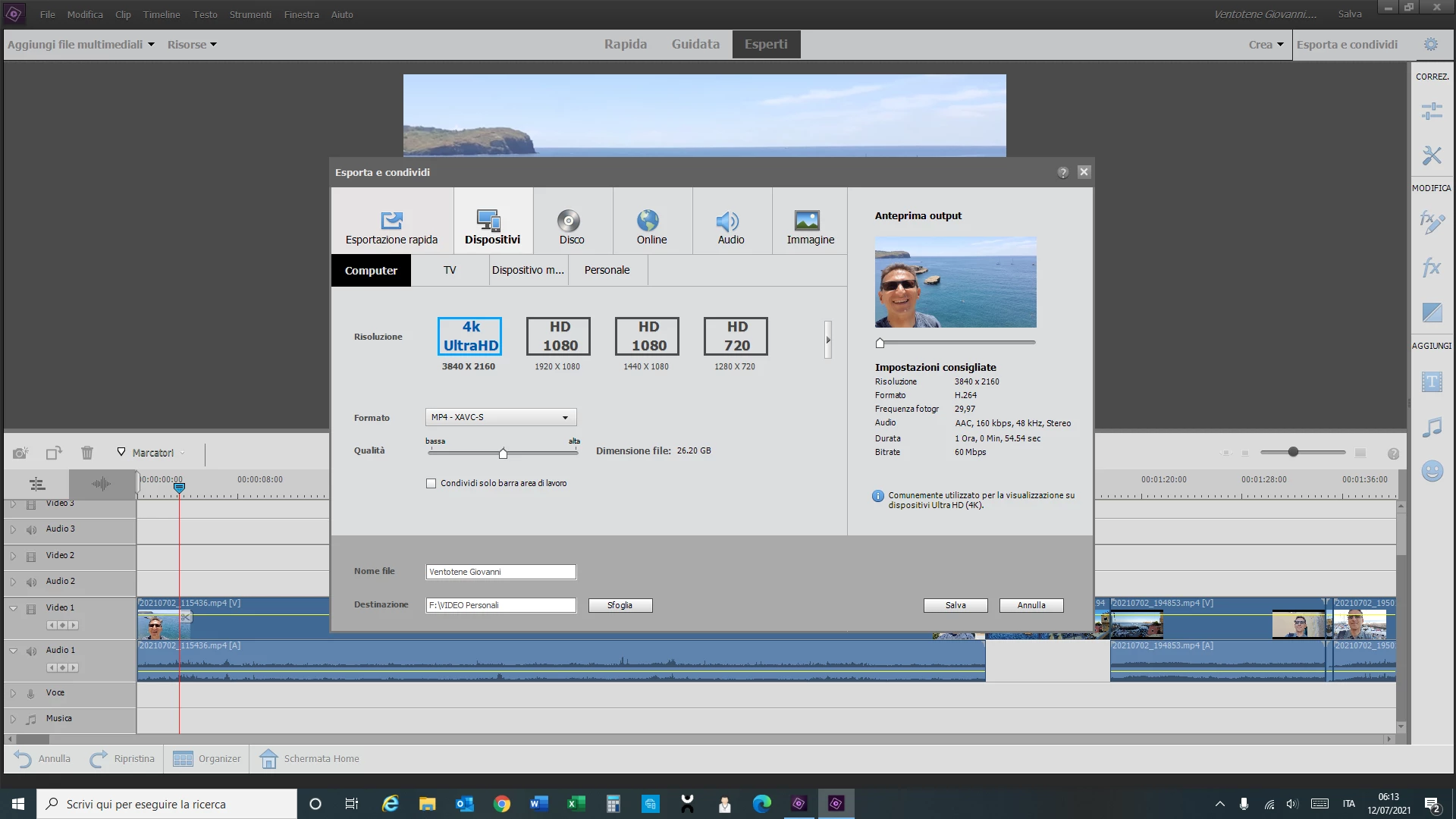

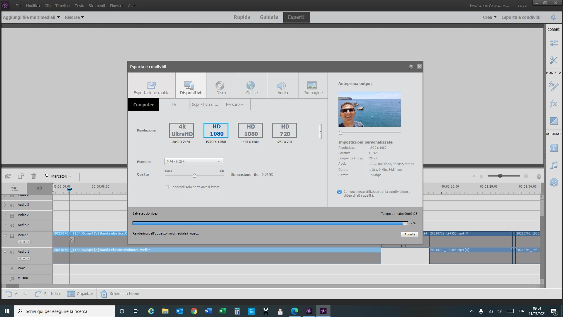

Premier Elements 2021 doesn't complete export. The process will stop at 95-97% without errors.  The .mp4 file is not created. The clip I am tring to create is just a sequence of 4K videos and photos (1 hour duration, output 4k video) with original audio without any effect applied. It takes about an hour and a half to complete the first 95-97% then you can see non more progress. The program doesn't crash. The program allow to stop the process but if I wait (even a full night) nothing happens, there is no progress and no error message. I tried to separate the sequence in shorter parts. With a sequence of about 28 minutes the process is completed correctly. On the 6th June I succeded to complete a similar video of 1 hour and 19 minutes without any problem.

ISSUE SOLVED. After many tries I discovered that one of the video clips (about at the end of the sequence) was corrupted. I replaced the corrupted file with a good copy then everything worked normally.
I wonder why Premiere didn't returned any error message but just stopped in some kind of a loop.
