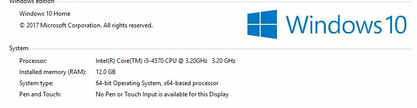

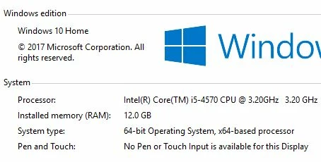

What model of CPU (processor) do you have in your computer?

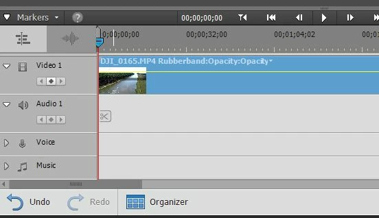

Your timeline indicates a perfect project/video match. You should get good performance on an amply powered computer.
Oct 9, 2018 12:01 AM UTC
is this what your looking for?
Also I discovered It will not play work 1080 videos ether.

I don't see anything in the video specs that would keep you from editing this video, so I'm not sure what your issue is. The bit rate is a bit high, but I don't believe that is an issue.
As an experiment, download Handbrake, an excellent, free video converter. Load this file into it and output a new MP4 from it: 3840x2160 30 fps Constant Frame Rate. See if this converted file works any more efficiently in your video project.
BTW, when you add one of your 4K files onto your Premiere Elements timeline, do you see a yellow-orange "render" line above the clip? Ideally you should NOT see this render line until you add effects to your clip. If you do see it, then the program is not matching its project settings to your video clip, which can cause very poor performance.

the camera is on a UAV, DJI Phantom 4 pro
I have tried the video converter and the results are the same, tried the program on both my HDD and SSD (I have a clone)
I don't see a yellow-orange "render" line above the clip.
