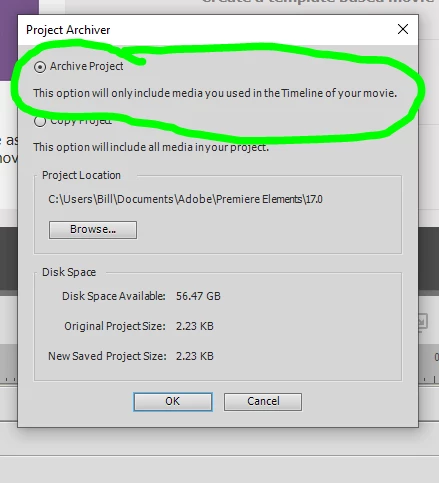

    May 22, 2019 6:52 PM UTC
    There is an option in the Files > Project Archive menu that may do what you want.  I've not used it enough to know how it actually works, so be sure to test it before you dispose of media you don't want to keep.
