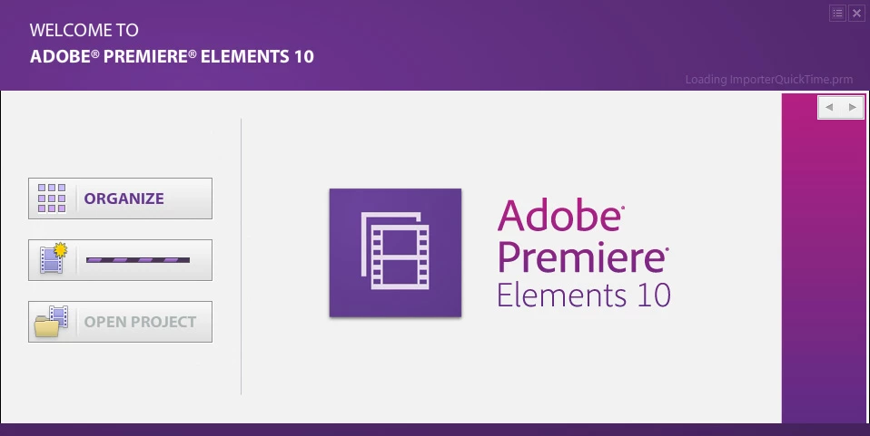

Premiere Elements 10 Hangs at Loading Importerquicktime.prm then resets
I purchased the Premiere Elements 10, and installed all the discs onto my 64 bit Windows 7 computer. It opens up the screen for "organize, new project, open project" and when selecting New Project it opens a load screen, and then closes and goes back to the main screen after it gets to "loading importerquicktime.prm"
I just downloaded teh newest quicktime, and still isn't working
