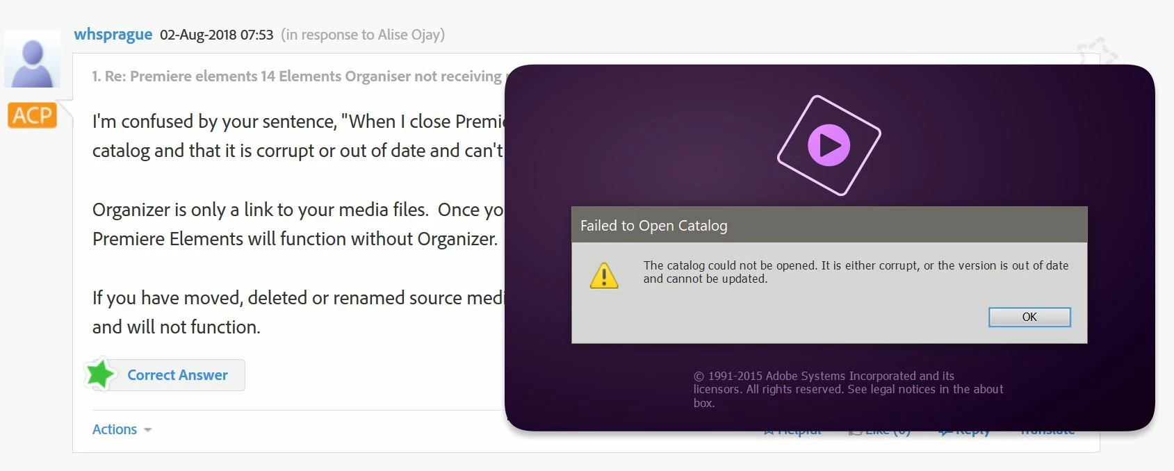

I have been working on two large projects in Premiere Elements 14 for several months. They are, agonisingly, not finished. Suddenly from a few days ago when I try to add a new file using 'add media' files/ folders the file does not appear in elements organiser. I have retested the process umpteen times. When I close Premiere and re-open it I get the error message that it has failed to open the catalog and that it is corrupt or out of date and can't be updated.

I have tried uninstalling and reinstalling Premiere Elements 14. Curiously when I did this when I opened Premiere I got the same error message about it failing to open the catalog but when I opened a new project I was able to add a new file and the Organiser was empty except for that one new file. Excited I closed that test project without saving it and re-opened one of my on-going projects but the old Catalog was back in Elements Organiser and again I was unable to add any media to Elements Organiser. I closed it down and opened a new project again but the old (apparently corrupt ...) catalog was back. I have not been able to get a new file into Elements Organiser again.

Thank you for replying to my question. I have not moved any source files. The error message appears when I open Premiere Elements (not organiser). I assumed it was related to the problem I am having. I will insert an image of this error message below.
