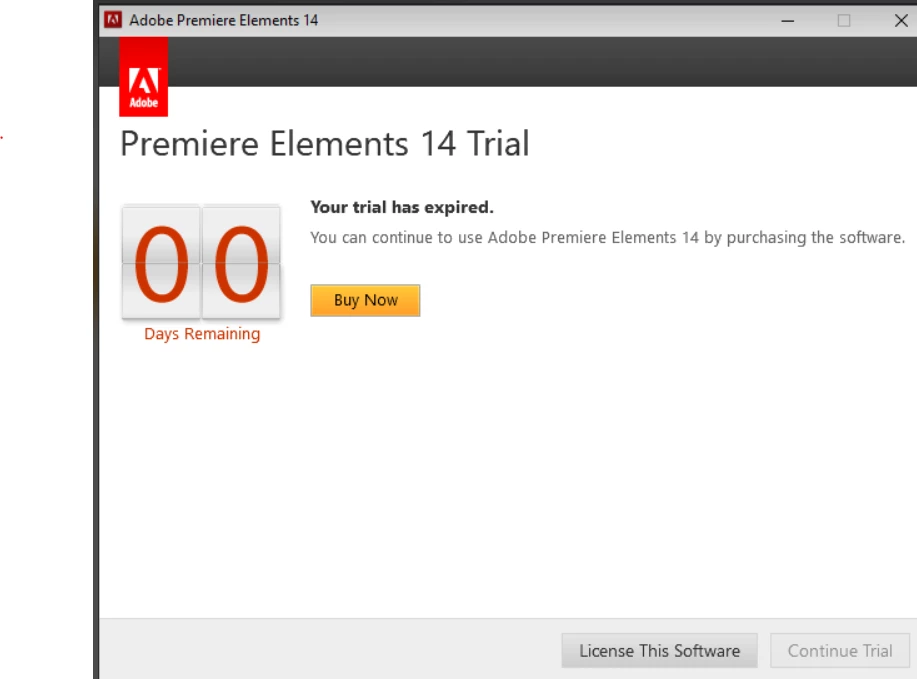

Premiere Elements 14 Purchased in 2016 is Now Locking Me Out Telling Me My Trial has Expired
In 2016 I purchased the Teacher/Student Version of Premiere Elements 14.
I got 2 activtion codes and installed it on my laptop and desktop.
Unfortunately, recently, the one on my desktop is displaying a "Trial has expired message" and is not letting me proceed with using the software.
I was wondering if anybody has ideas on how I should proceed (I still have the activation codes.).
Thank you

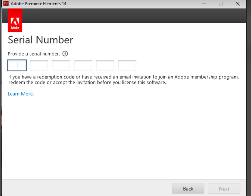

>2 activtion codes
That is unusual... do you possibly mean that you had a redemption code which you used to get a serial number?
A serial number is 6 groups of 4 digits - all numbers, no letters
Such as 1234-5678-1234-5678-1234-5678
Jan 10, 2022 11:02 AM UTC
Hi John,
I think you are correct. I had to redemption codes.
In the end, Adobe contacted me directly and after some back and forth was told that since Premiere Elements 14 is no longer supported I am going to need to  purchases the newest version for $79.

>under the impression that the whole Elements line where 1 time purchases
That is true... but a redemption code, which is not the same as a serial number, does have a limited life

Jan 3, 2022 4:57 AM UTC
Click help... is there an option to enter your serial number to activate the program?
Jan 10, 2022 11:06 AM UTC
Hi John, I don't seem to have that option.
When I click l"Liscence this software" it brings me to this:
Where I reinput my code but it loops back to the first image.
