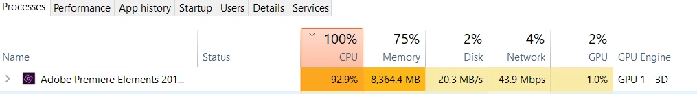

Hi, I have just bought a brand new laptop, 16GB RAM, Geforce GTX video card with 4GB Memory, intel i7, 256 GB SSD drive but every time I start up adobe premiere elements 2018 it never loads the video project and crashes within a minute or so of starting up. The clips are in the correct folders and everything is in the right place. All the while the CPU is running at 100% and the fans are going crazy, like the laptop is ready to take off. Something is definitely wrong with Elements 2018, my specs are at least double what your recommended system requirements are and still I cannot load in a saved project to continue editing.

I don't see a question in your post, but I assume you're looking for a solution. Most likely the issue is related to challenges with the drivers for your graphics card.
As you may have seen on this forum, you can often fix this by downgrading to an earlier nVidia driver. Or you can wait until nVidia comes up with a driver that works with Premiere Elements. But there's otherwise no easier fix.

But don't be short sighted.  Your brand new laptop was probably delivered with an "old" graphics card driver.  Try updating it from the Nvidia website.
