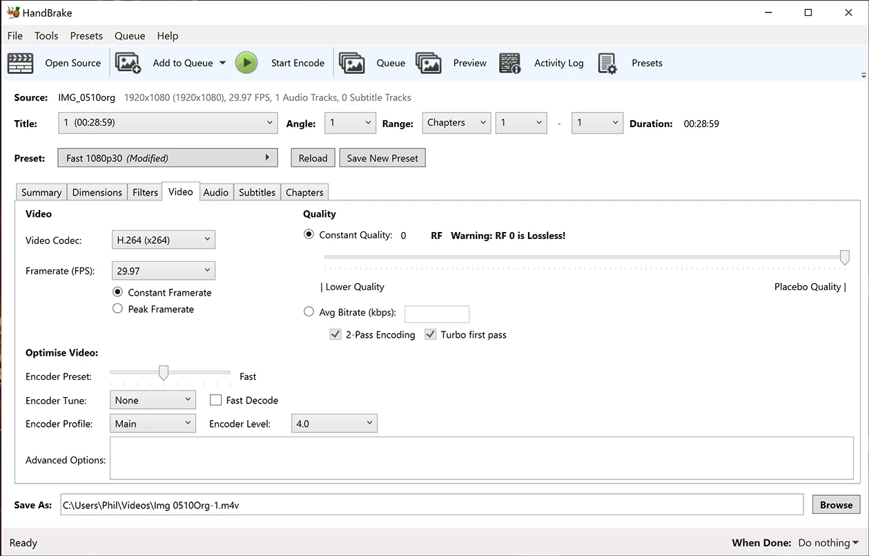

Converting the HEVC h.265 video to h.264 using Handbrake and then using that h.264 file in the project seems to have resolved the choppy video after save problem.
I matched the output FPS to 29.97 and selected Constant Framerate along with Lossless Quality. This took about 47 minutes for a 30-minute clip and resulted in a file size 2 times the original. To my eye the quality of the video matches the original footage but there may be a barely perceptible audio sync issue – not 100% certain on that.  The finished mp4 exported from Premiere Elements resulted in the same size as the original export.
