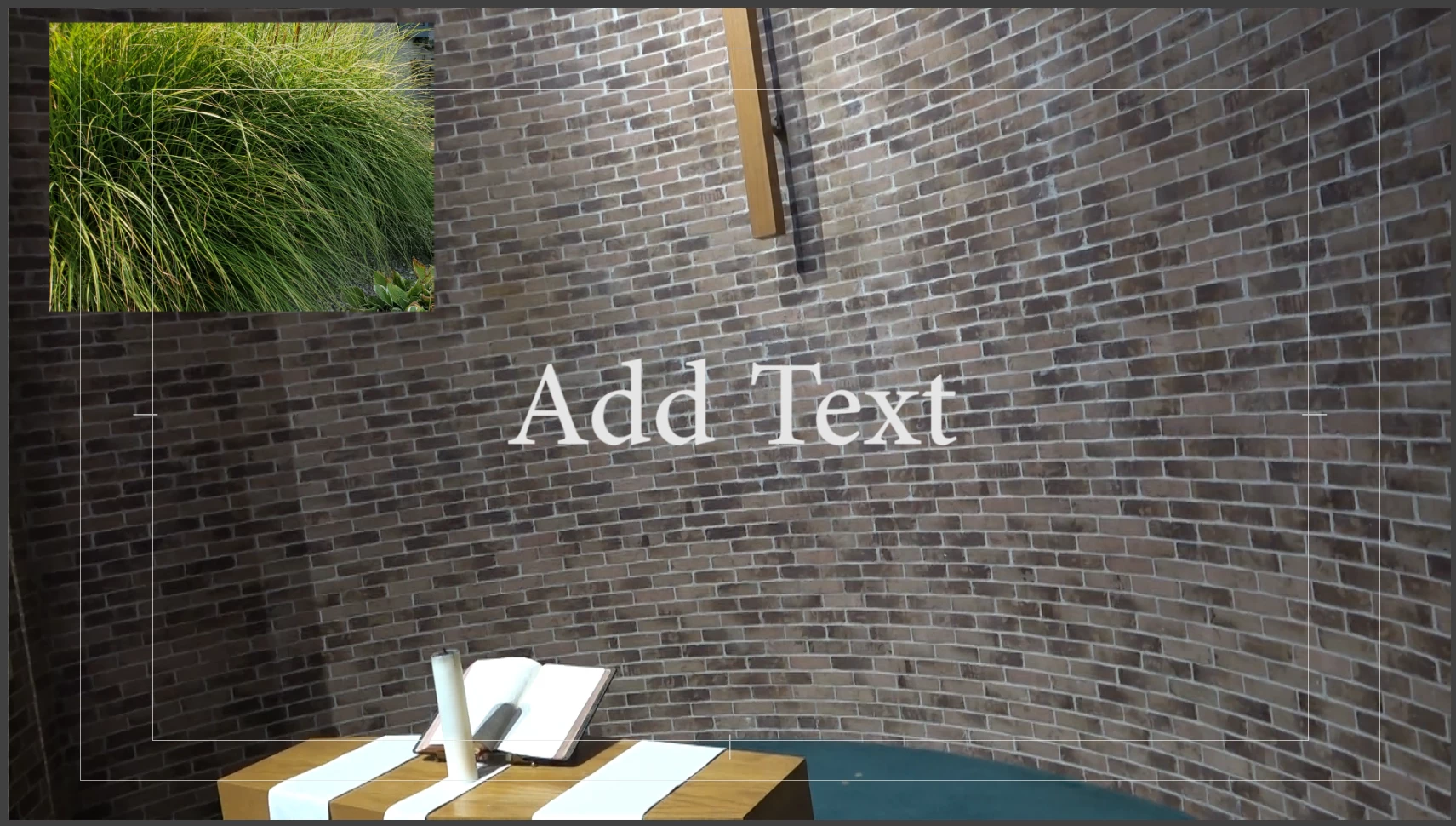

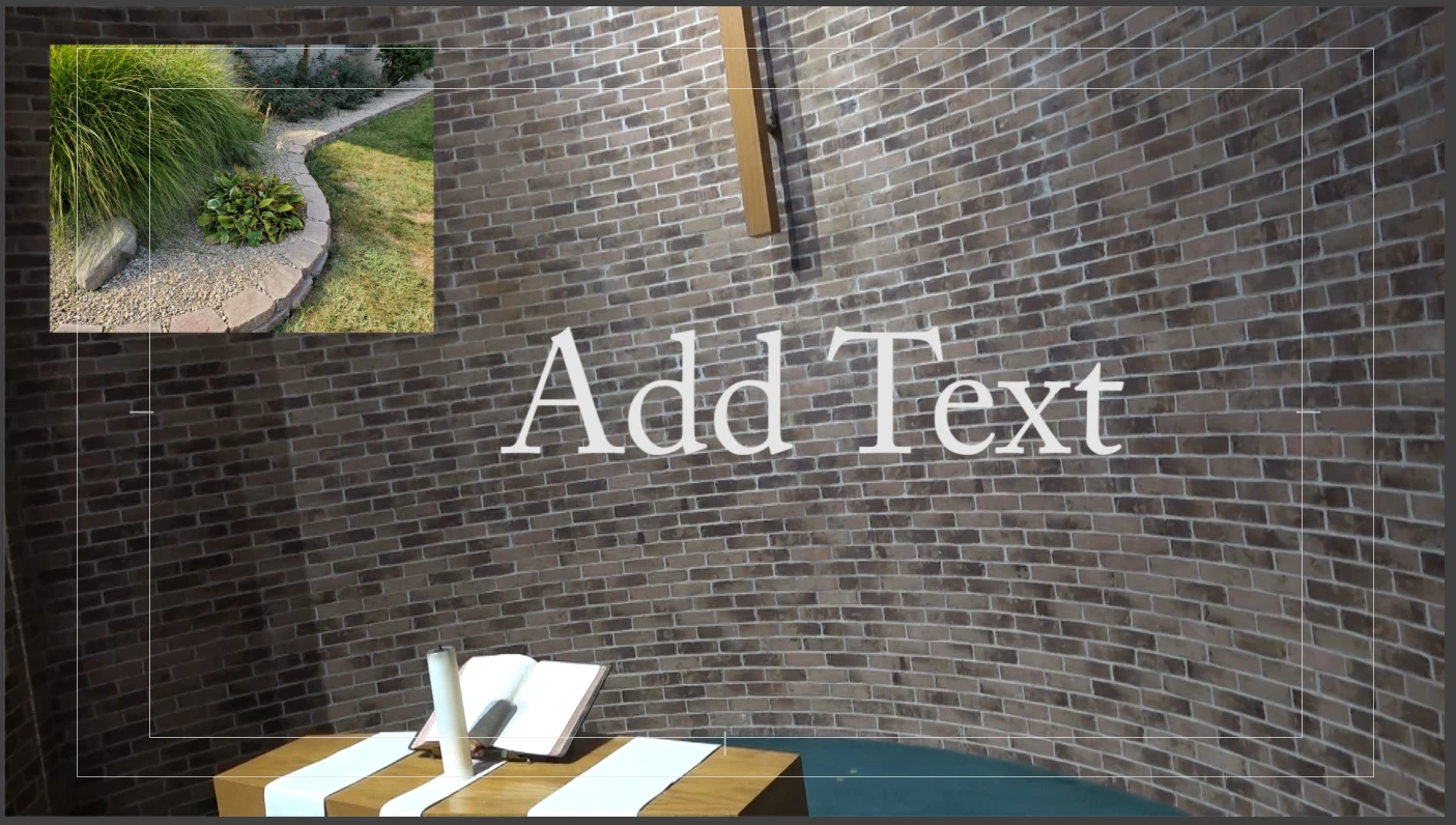

I've attached a couple of photos to this post. Each represents the same process, but one is in 2018 and the other is in 2021. I took a video, added a title slide on top of it ("Add Text"), inserted a ~4000x3000 JPG through the Text menu, then scaled the image to 25% and moved it to the corner (last part done just to see the video frame for reference). In the 2021 attempt, the inserted photo was cropped as soon as it was inserted (and I cannot figure out a way to undo that). You can see the whole image in the 2018 attempt.
