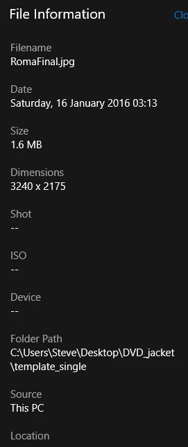

    Yes, it is exactly like that. This is the file info:
