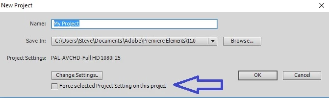

I can't tell from those dimensions if these clips are widescreen or normal but, eventually, they will be viewed on a widescreen TV. At the beginning of this project, in Premiere Elements 11, is it best if I go to File | New | Project | click on the 'Change settings button', select PAL, AVCHD | DV | Widescreen 48Khz and then commit Prem Elements 11 to 'Force selected Project Setting on this project'?

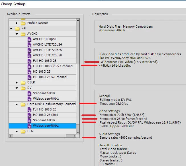

    On the Timeline, with these settings
    the movie plays back just fine - both in video and audio terms.
    I don't know what type of camcorders the footage came from, but I downloaded them from a laptop onto my own PC via a flash drive, which is why, under Project Settings, I selected 'Hard Disk, Flash Memory, Camcorders, in the 'Available Presets' pane.

    I appreciate that 'If these videos are from a standard source the program will automatically set up to match the project settings to the video specs', but they won't automatically go into 25fps mode, will they?
    Don't I have to force that here:
    Thanks again
