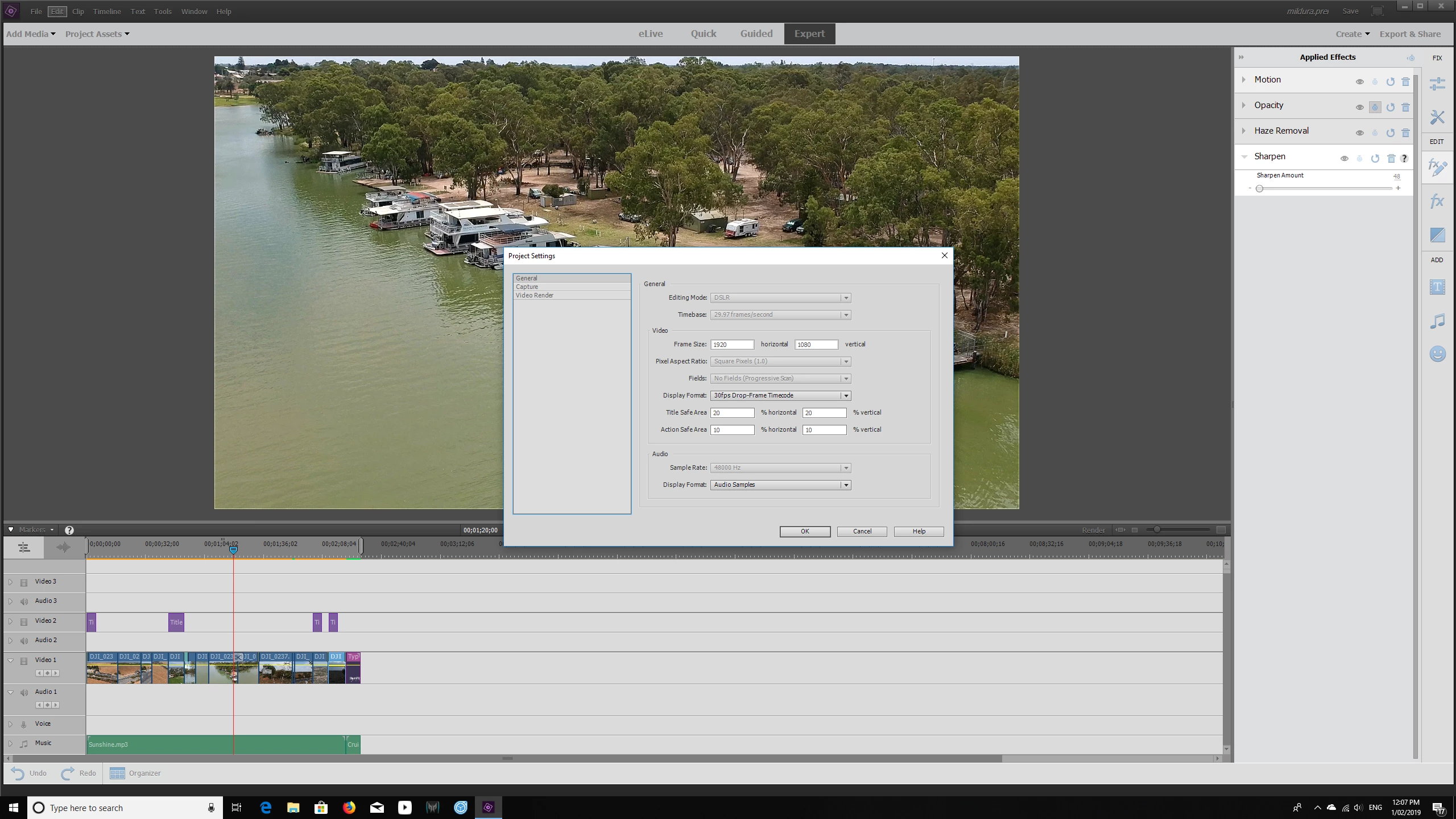

Hey there. Before I go on I must tell you that all my setting are set correctly to the footage going on the time line eg 1080p 29.97fps. I edit the video and everything looks great, have some sharpening, haze removal etc etc and I am very happy with the footage I see in the preview window. When it comes to rendering, I set it to 1080p, Hight quality, level 5.2, profile high, vbr 2 pass at 20/24mbps. the resulting render looks as though I haven't done any editing to the footage at all. it looks as if there isn't any sharpening at all and looks nothing like the video in the preview window. Anyone have any idea what is going on? I have tried all sorts of settings but nothing seems to improve the quality of the rendered video, it's doing my head in! Cheers in advance

    Post screenshot export settings.
    Try cbr.

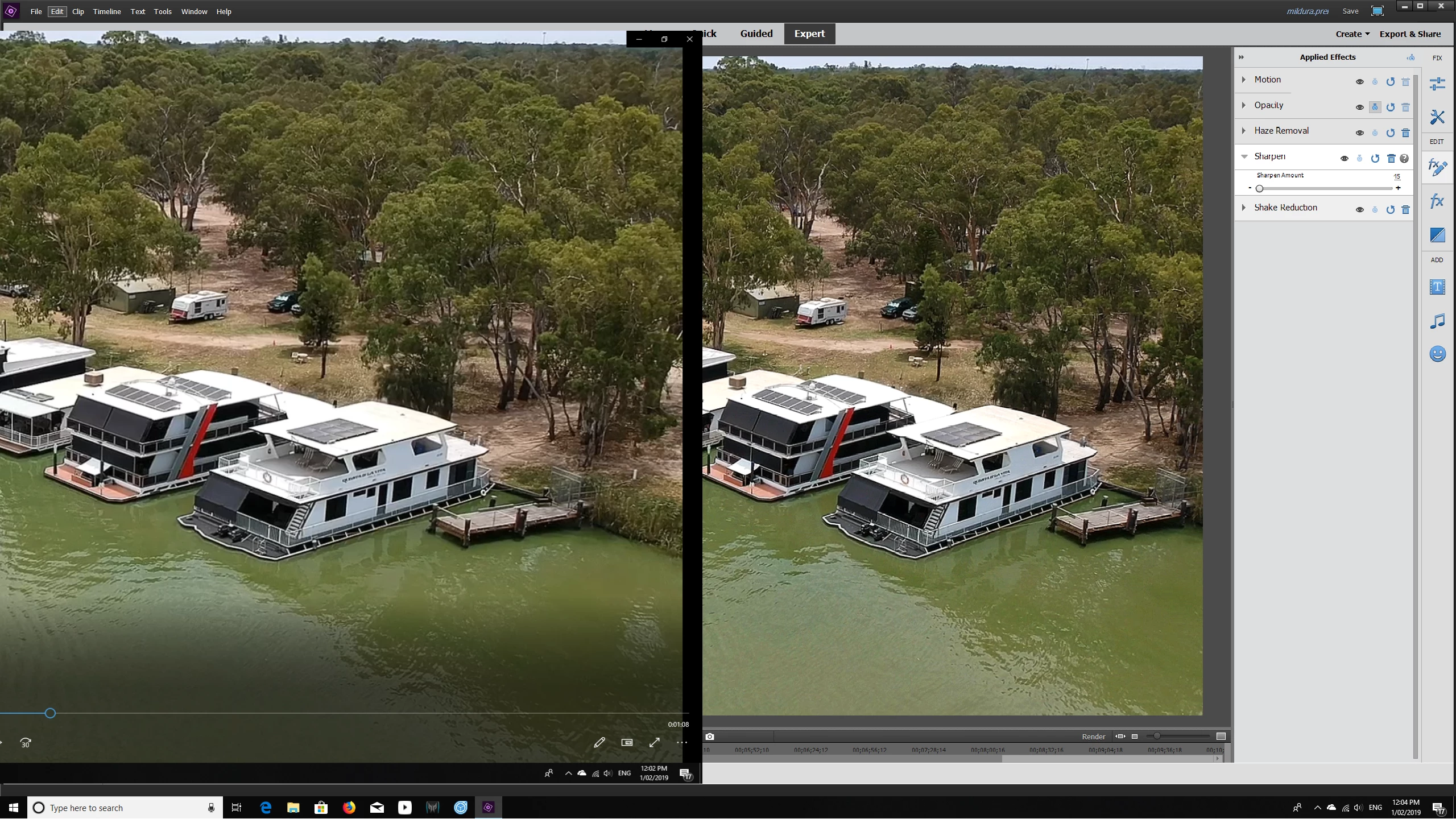

    Based on what you've told us, I can't imagine why your output video isn't virtually identical in quality to your source video. (Though it still might help to know which version of the program you're using.)
    Can you share a screen capture of the two videos, side-by-side, so we can see the difference?
    Or can you share some of your original footage via a Dropbox public folder so we can run our own tests?
    mattn93896567
    Feb 1, 2019 2:14 AM UTC
    The image on the right is the project image and left is the rendered image. There is a quality loss if you notice the small jetty and overall pic quality and coulor
