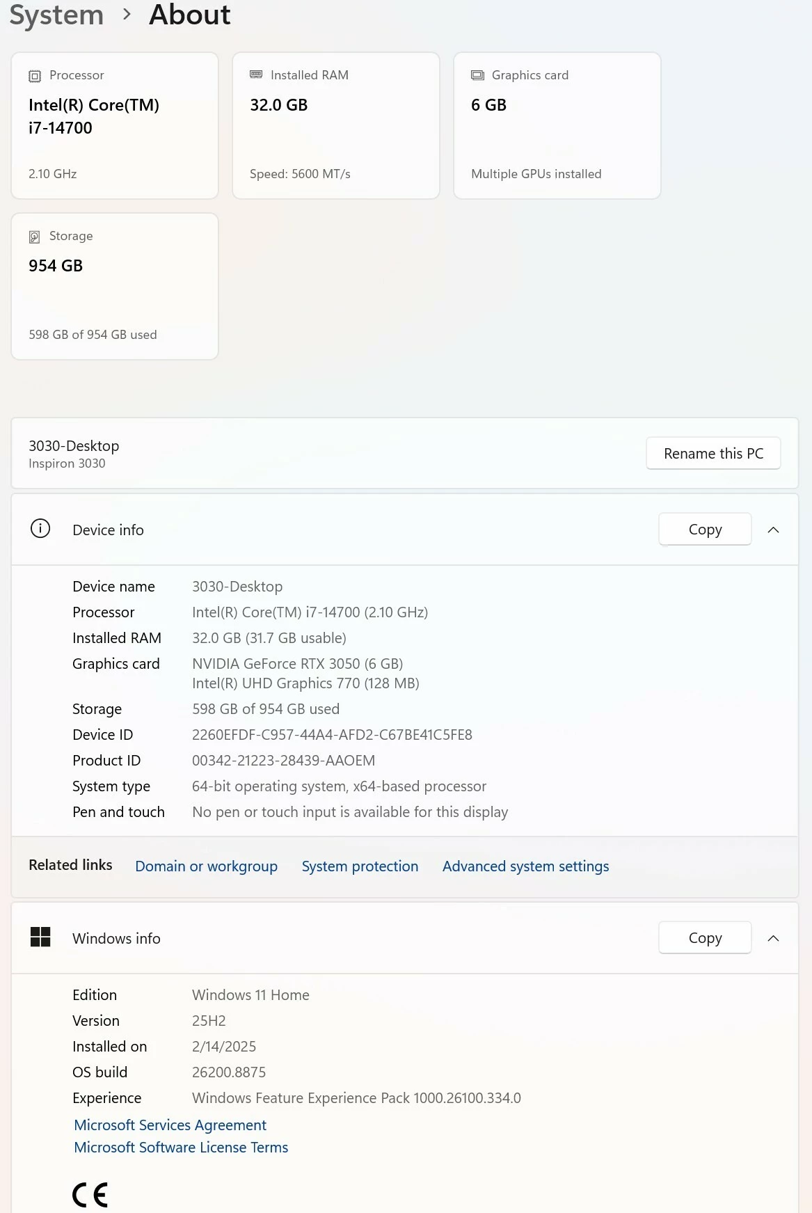

    Please post comleet comp specs and OS build.
    Make sure your graphics card is on the most current driver (Nvidia studio driver) Install manually and clean install.

    Thank you Ann and Steve.  Some more info on what I’m seeing and what I’ve tried so far.
    Occasionally these short (15 sec) clips will jump in & out of focus while previewing, especially if I pause the preview.  Timing issue - it appears that when it does suddenly jump into focus, it also jumps back a fraction of a second.  I did have the most recent version of GPU driver installed but I did a manual clean reinstall - no change.  I also tried installing an older driver to see if it helped since everything was previously working - no help.  I uninstalled/reinstalled PE (again) and things got weird.  Instead of being way out of focus and moving from out-of-focus to in-focus, clips would either show normally of as a tiny thumbnail in the upper left corner of a green background - occasionally moving between that state and normal.  I reinstalled PE (3rd time) and it’s back to out of focus clips.
    The different clip dimensions and the trailcams using oddball CODECs both sound like possible issues BUT I’ve used this same computer (and others) and same trailcams to compile about 125 clips and month for about 10 years (~15,000 files) with no issues until this past week.  So something has changed besides the files I’m using.  I’ve processed numerous 4k-60 files, both stand-alone and intermixed with 1080x1920 w/o issues.  Adobe appears to say the PE 2025 supports 4k-60.  Moreover, my older PE 2022 continues to handle these mixed trailcam clips w/o issue.  If I place a single trailcam clip recorded at 1080 x 1920 at 30fps, into PE 2025, there is about a 50-50 chance it will be blurry.  If I include more files the likelihood of blurry clips increases.  I can (and likely will) change all of my trailcams to record at 1080 but I don’t think that is going to solve my problems.  I will continue to play with different scenarios and let you know if I stumble upon anything meaningful.
    I would appreciate additional feedback if anyone has additional input or similar experience.  Computer specs posted per your request.
