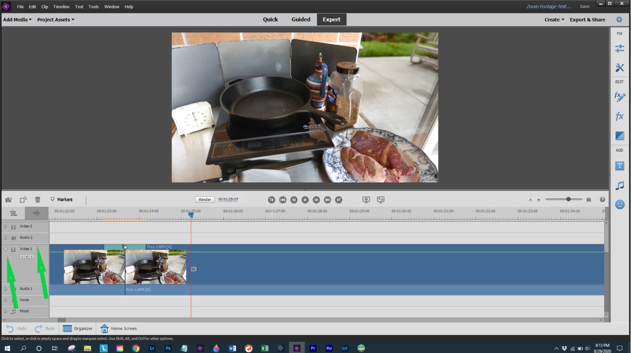

Emily,
I'm guessing a little but I think you are asking about "Expanding the Track".   Toggle an expanded track with the little arrow left of the Video label.  Then to expand it further, grab the line at the top of the track and drag it up.  The two green arrows show the spots I'm referring to:
