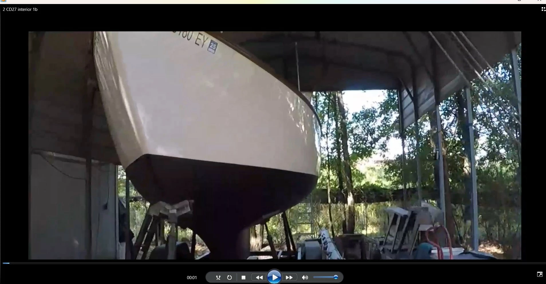

When I did a 15% crop vs smooth rather than the default 50% it added less of a black border but it's still there. I left the smoothness setting at 50%. Here is one screenshot without shake reduction and one with.

Go to the program's Edit menu and tell us what appears on the General page under Project Settings.
Then open the video you're editing in the free download MediaInfo. In MediaInfo, set View to Text and then copy the complete report it generates and paste it to this forum.
With these two pieces of information we may better be able to help you. Yours is by no means a typical experience, so let's see if there's a mismatch or a codec issue in your video.
