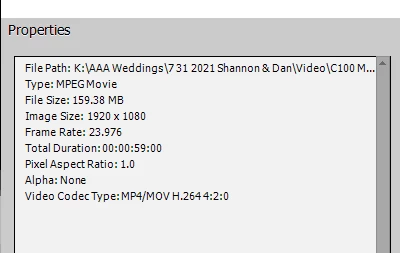

I shot the following footage in slow motion (1/60 shutter speed & 59.94P) but playback on YouTube appears jittery: https://www.youtube.com/watch?v=D7neIAJ11QM
The clip properties show the Frame Rate as 23.976 so I think that has something to do with it.
Also, is this relevant at all?  I had the Project Settings both at 24fps and changed it to 30fps but both playback jittery.

The shutter speed of your camera has nothing to do with slow motion. Unless your camera has a slow motion setting and your original footage came out of the camera in slo mo. And that wouldn't involve Premiere Elements at all.
24p should not give you uneven playback either. That's cinema frame rate.
Your uneven playback may have something to do with your project speed being different than your movie's specs. If your video is shot at 60fps, your project should also be set to 60 fps.
