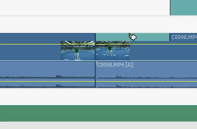

I have built up a long video which I have splitted in multiple subvideos.
It's a tennis video in which I fade to the next exercise after the exercises. I mostly use the "soft fade" transition here. Now it is often the case that Premiere Elements does not seem to recognize the transition of the two scenes and does not place the crossfade exactly in the middle, but on one of the two scenes. This then often results in a problem in the final video, namely that the transition is not clean but a bumpy "jitter", sometimes you can see the black background. Here is a screenshot from Premiere Elements and how this transition looks like in the final video.
How can I prevent this? What is going wrong? I have the problem with about 10 of 120 scenes.

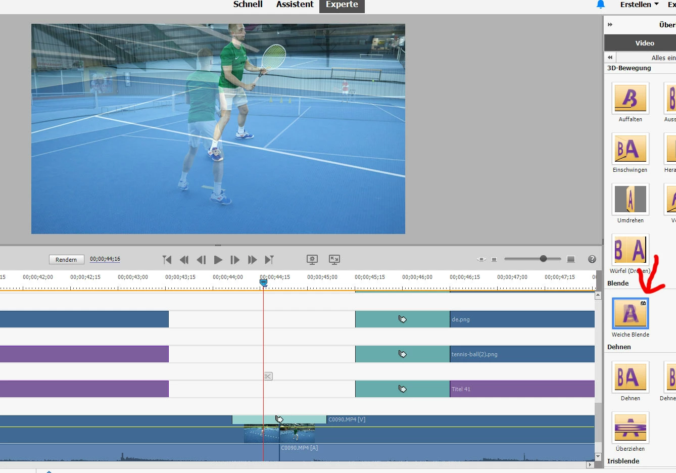

thank you very much for your explaination. I watched the video and now I finally understand why transitions cannot be placed to the middle. Too bad, that does not seem to solve my problem. I fixed the transitions and they are all placed in the middle now. But I can do whatever I want. When i fix one problem it occures on an other part of the video. Sometimes I see the problem already in the editor, sometimes I only see the problem when I exported the video.
Im using "Weiche Blende" transition, thats the german word - I have added a screenshot. I saw that there is a strange black symbol on it. When I click it more often I can let it disappear. Its so weired, I dont know what to do.... Im using version 2023.

We call that one "Cross Dissolve" and I too am using 2023.  I would like to try to first duplicate what is going wrong for you and then try to help you fix it.  So far, I am not having trouble using it on my system.  I can place it directly on the cut line between clips without trouble.

I have created a completely new project and imported the videos without any further modifications. I just put the transitions over the and exported. Same result - black flickering on transition parts....
