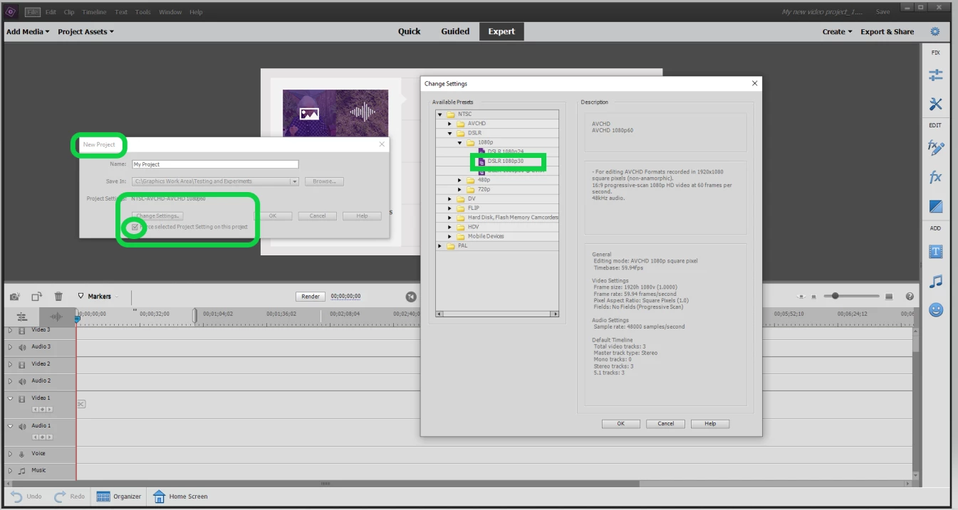

Bill SpragueCorrect answer
Apr 22, 2020 12:55 AM UTC
"From what you say and my screenshot, does it mean the problem is the "HD 1080i" editing mode?"
The "i" for interlaced is left over from when we needed low res, standard definition over the air broadcasts to tube TVs like your grandparents had.   So, that is the probable cause of the "aliasing artifacts".
You won't know for sure until you try it on your own work, but I bet a beer or two your problem is solved.
Unfortunately you can't change project settings once in the project.  You have to set up a new project.  There is a drop down menu for choices and a check box to force the project to use the selection.   There is also a check box in General Preferences for "Default scale to frame size"  That will put your JPEGs and graphic larger than 1920x1080 neatly into your frame.

Bill SpragueCommunity ExpertCorrect answer

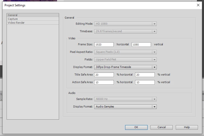

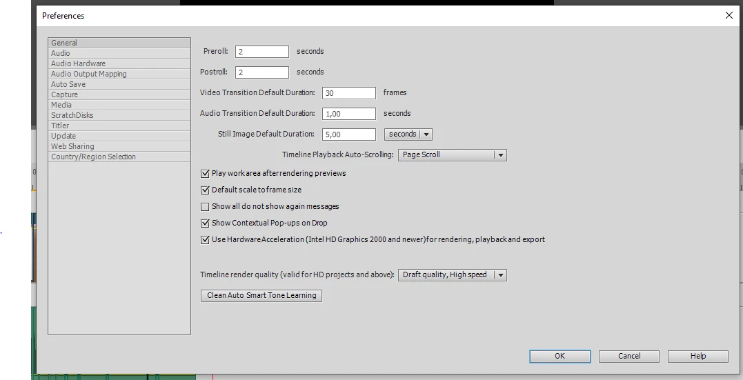

Apr 21, 2020 3:49 PM UTC
Your screen shot is of General Preferences.  Can you post screen shots of your project settings and output settings?   If your source JPEGs have enough pixels to fill a 1920x1080 frame, you work in "progressive" and not "interlaced", you should have a good quality output.
Apr 22, 2020 12:29 AM UTC
My bad, here it is. For the images I tried jpg, png and psd with the same result.
I initialy planned on producing 2160p video so my psd files are 3840*2160.
For jpg I tried 3840*2160, 1920*1080.
For png I tried 1920*1080.
And I tried with the psd directly too.

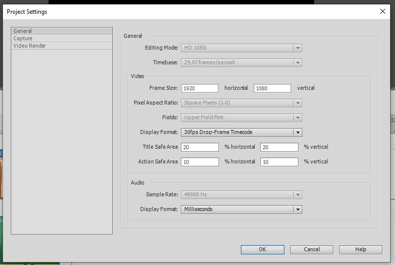

Apr 13, 2020 2:37 PM UTC
What are the project settings?  ( Edit > Project Settings > General )
Apr 21, 2020 5:15 AM UTC
Sorry for replying so late I completely missed the notification.
Here it is, let me know if you need more info.
