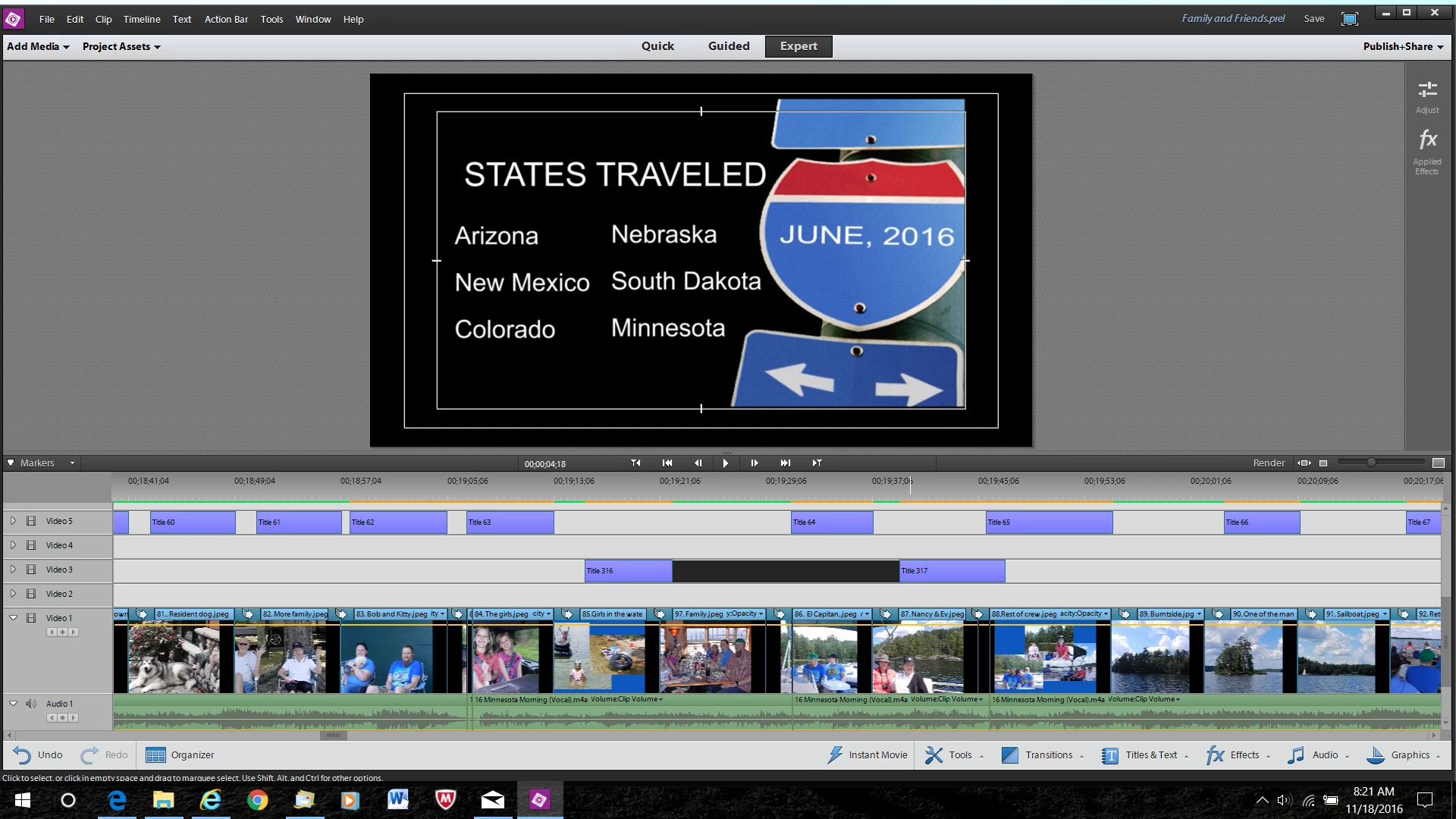

I have read the forum questions regarding this and still not able to come up with a solution. I am basically finished with my project and want to render it before I burn. Here are my specs
Premier Elements 12
Windows 10
Gray tabs span the entire timeline
Video Preview "same as project"  236 GB
Imported clips are 1050x750
450 clips
Settings  DSLR
Time Base 29.97
Frame size 1920 x 1080
Pixel Ratio Square Pixels (1.0)
Are there any suggestion that will help? The first portion of my project is rendered and than there are sporadic orange and green lines on the rest. When I try to render it starts briefly and than quits. It than revert back to the beginning of the project.

Nov 18, 2016 1:22 PM UTC
Is there a yellow-orange line along the top of your timeline?
Can you post a screen capture of your timeline to this forum so that we can see what it looks like?
BTW, what model of camcorder is your video coming from and what format is the video file? 1050x750 is not a standard resolution. If this is video from screen recording software (like SnapIt) you may need to convert the video from variable to constant frame rate.
Also, please confirm that you have Quicktime 7 installed, per the program's system requirements.

Nov 18, 2016 3:37 PM UTC
Okay here is my screen shot. I am using a Nikon Cool Pix Camera. My pictures are either 4x6 or 5x7  I do have some video clips that are also included in my project. They come from the Nikon Cool Pix, they are a MOV file and are 1920 x 1080.
When I hit "render" there is a screen that "flashes" very quickly and shuts off. It states 1 of 710 previews and 85 of 60725 frames rendering
Also I have Quicktime 7.7.9 installed
