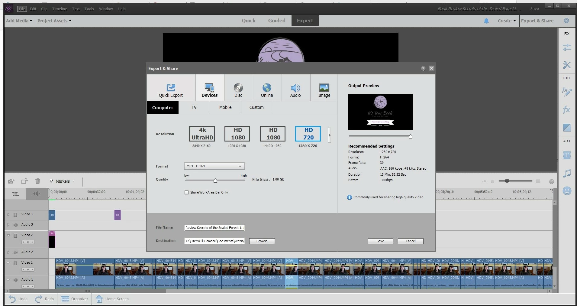

Hi everyone. I seem to have a rather unique issue. I browed the community, but couldn't find my exact issue, so I hope someone here can help me out.
I made a video a while back and exported it. It contained titles and texts. All was well. Today, I decided to change something in the video, so I opened the program, cut something out (that's all I did--cut out maybe 5 seconds of videoframe), saved it under a new file name and then exported it under a new file name (it's really the same name with a 1.1 attached).
After the export, when I open the new video, suddenly my titles are gone. The text in the video is still there, but the beginning title and end title do not show. Instead, I get a few seconds of black screen until the video starts and a few seconds of black screen after it ends.
I tried rendering. I tried moving the titles into different Video sections. None of that helped. (I should mention: I also have an image attached to the titles on a separate video line, but they don't show either).
When I go to export, it all shows fine in the little box titled "output preview".
I'm confused why a previously perfectly fine video gets title screwup from nothing more than me cutting out a few seconds of videoframe....??
How do I get those titles to come back?
Thank you!

Feb 17, 2021 10:19 PM UTC
I can guess at a few possibilities.  But, without knowing more, they really are guesses.
-You may have started the project "awhile back" in an earlier version of Premiere Elements and then opened it in a newer version.
-You may have output using the work area bar limits.
-Your "titles" may involve source files that have been moved or deleted.
Screen shots of the timeline, output settings and more details would help.
Feb 17, 2021 11:29 PM UTC
Hi Bill, thank you for your response.
I only own Premiere Elements since Christmas 2020, so I doubt the version changed between creating the video and changing it. By awhile back I meant no more than three or four weeks. Sorry for the confusion or lack of clarity!
No source files have been moved or deleted since. I can be very certain of that.
Attached is a screenshot of the output settings. I'm not entirely sure what you are referring to about the work bar area limits, but if I do understand correctly, I do not have that checked.
Feb 17, 2021 11:31 PM UTC
I should add: the screenshot is taken after I'd moved the titles and texts up a video level.
