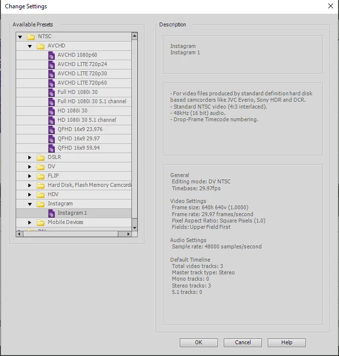

Firstly I check to see what type of files the presets were. Come to find out I could edit the sequence preset in Notepad. I chose a standard NTSC 48k Standard file and edited the '<VideoPixelAspectRatio>' to 640x640. Then I found another line of code '<VideoFrameSize>' and changed that to 640x640.
The two new lines of code are as follows:
<VideoPixelAspectRatio>640,640</VideoPixelAspectRatio>
<VideoFrameSize>0,0,640,640</VideoFrameSize>
From there I saved the file as a new preset with the same file extension as the others, placed it in a new folder in the NTSC preset main folder and started Elements 15.Started a new project and selected my newly custom preset.
Elements 15 then started with the correct 640x640 (1:1) aspect ratio. It seems to work alright. I noticed when I zoomed in on my media then rendered the whole timeline that the aspects were off.
The work around would be to make your movie, then manually change the video to fit the 640x640 screen size.
Its too bad that you cant choose your own project size. I was making a movie for my instagram account using GoPro mp4 files.
