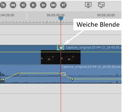

Ich arbeite mit Premiere Elements 2021 und habe einen clip am playhead in 2 clip geschnitten / aufgeteilt und an der Schnittstelle eine weiche Blende von 5sec eingefügt. Die Überblendung wird aber dann beim Abspielen im Vorschaufenster nicht angezeigt.
Was habe ich da falsch gemacht ??
Vielen Dank für eure Antwort

Based on your screen shot, I guessed that "weiche blende" might translate to "cross disolve" and tried it.
I made a simple cut and applied the 'cross disolve'.   Like you, I saw no effect in the preview.   I suspect the 'cross disolve' fails because it is blending near similar frames.  I tried a couple others and saw the same.   With 'Dip to Black" and "Random Invert" there is an obvious change in the previews.
Even with Anns suggestion, it didn't work unless it was trimmed to where there was a significant differents in the frames being blended.
The transitions that didn't work on a simple cut, did work where two different clips are joined.

Have no idea what transition soft aperture is but
you cannot drop a transition on a cut without trimming the ends first.
If your transition is 1 second trim left and right with 13 frames (25 fps)

the transition I mean is "soft cut" - the standard for video transition.
Trimming first seems very complicated and in the adobe manual I cannot find this procedure.
I think, if the transition is visualized in the "cutting window" (please see my screenshot, attached to my first question), it should be visible in the preview.
