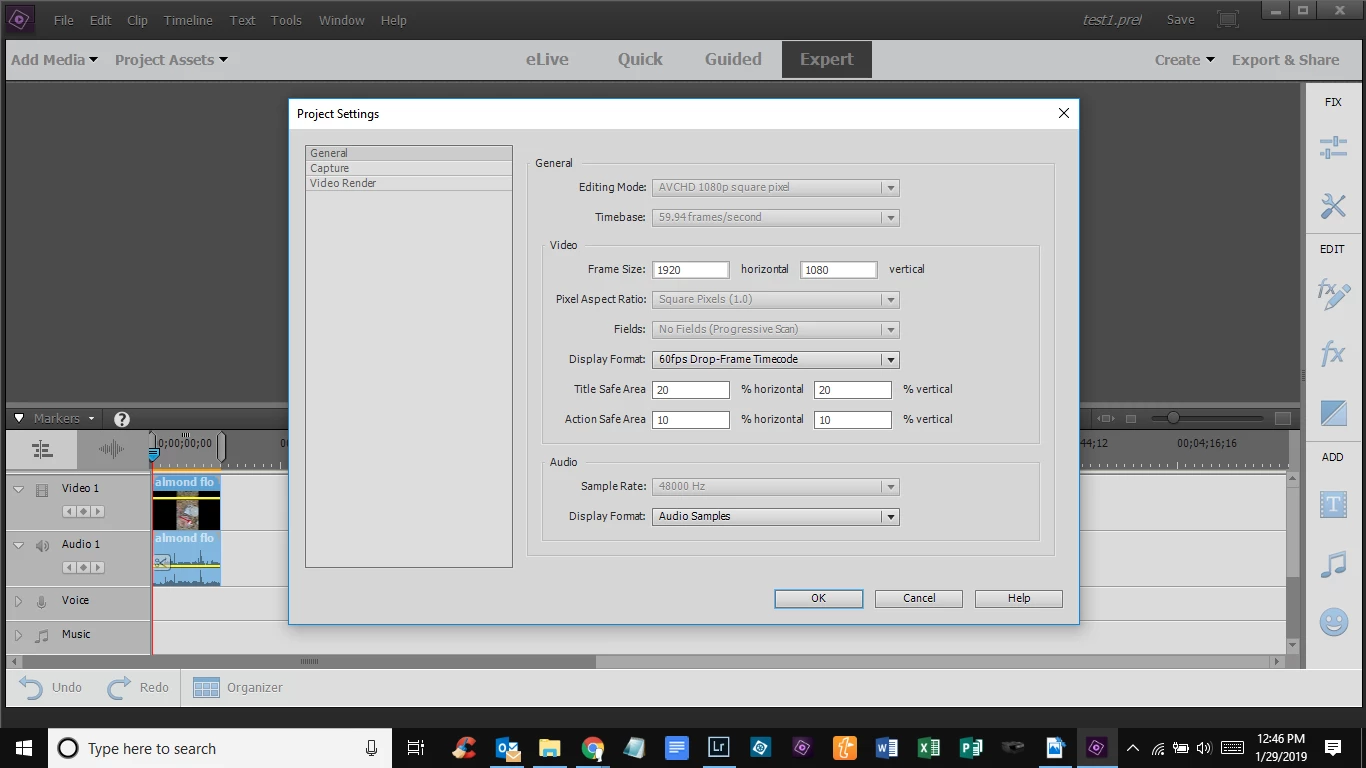

Set your phone to 16:9 or 1920x1080.  That's the "standard" screen size of TVs and computers.  But, that's what you've said you do.
In PrE, it automatically picks the best setting for the project when you slide the first clip to the timeline.  Or, it can be forced manually.  Which are you doing?

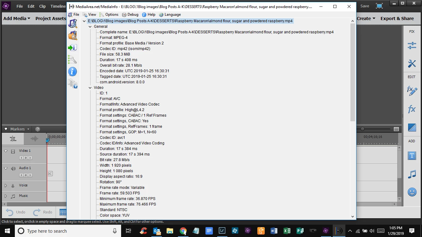

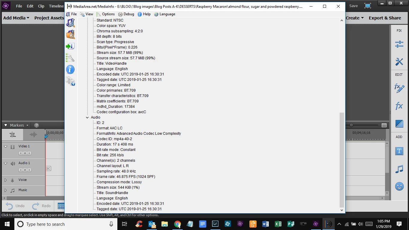

If that's not working, can you post some screen shots of your editing including the project settings?  It would also help if you got the (free) MediaInfo program and captured a screen shot of the "Tree" view of your video file.
Any chance you're holding your phone vertically instead of horizontally?

Thanks for getting back to me so quickly.
1) I don't think I've been forcing it...but I just started a sample project and did force the settings.  I noticed that on the projects that I didn't force the setting, PrE set them at 1280 x 720.
2) definitely not holding vertically.
3) attaching screenshots of sample project. Even though I forced to 1920 x 1080 (60fps), I will still have to drag out the corners...is that normal?
Peru Bob
Jan 29, 2019 6:16 PM UTC
You have variable frame rate video.  You need to convert it to constant frame rate before bringing it into Premiere Elements.
Here is a link to a Handbrake tutorial:
Fixing  video with Handbrake - YouTube
