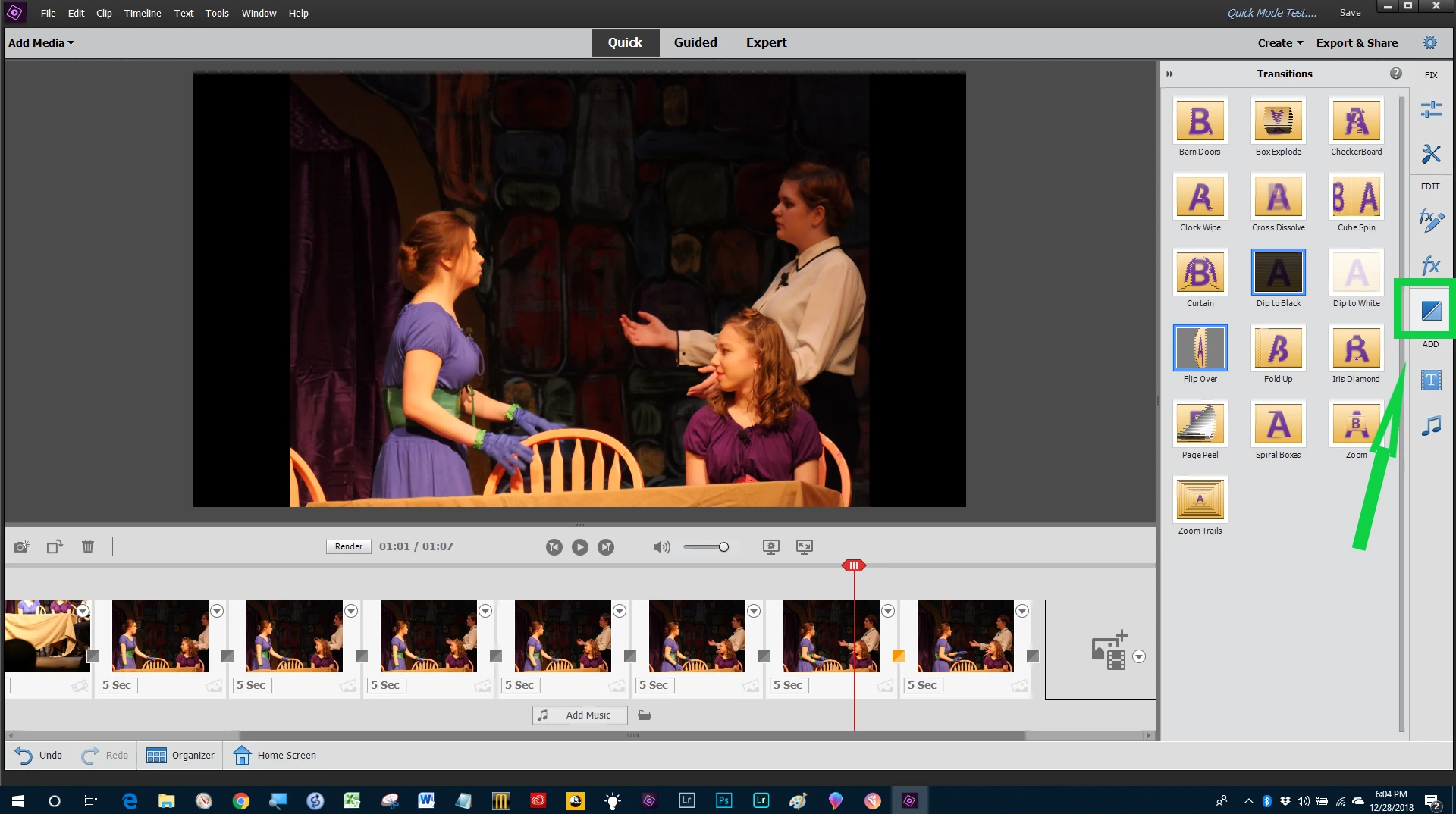

    The Transitions menu is under the Transitions button on the button bar along the right side of the interface.
    As I show you in my book, you can apply the Default Transition (by default, Cross Dissolve) to all of the selected clips on your timeline at once by right-clicking on your selected group and selecting Apply Default Transition.
    You can change the Default Transition by right-clicking on any transition in the Transitions panel and selecting the option to set it as the default.

    Do you see this?

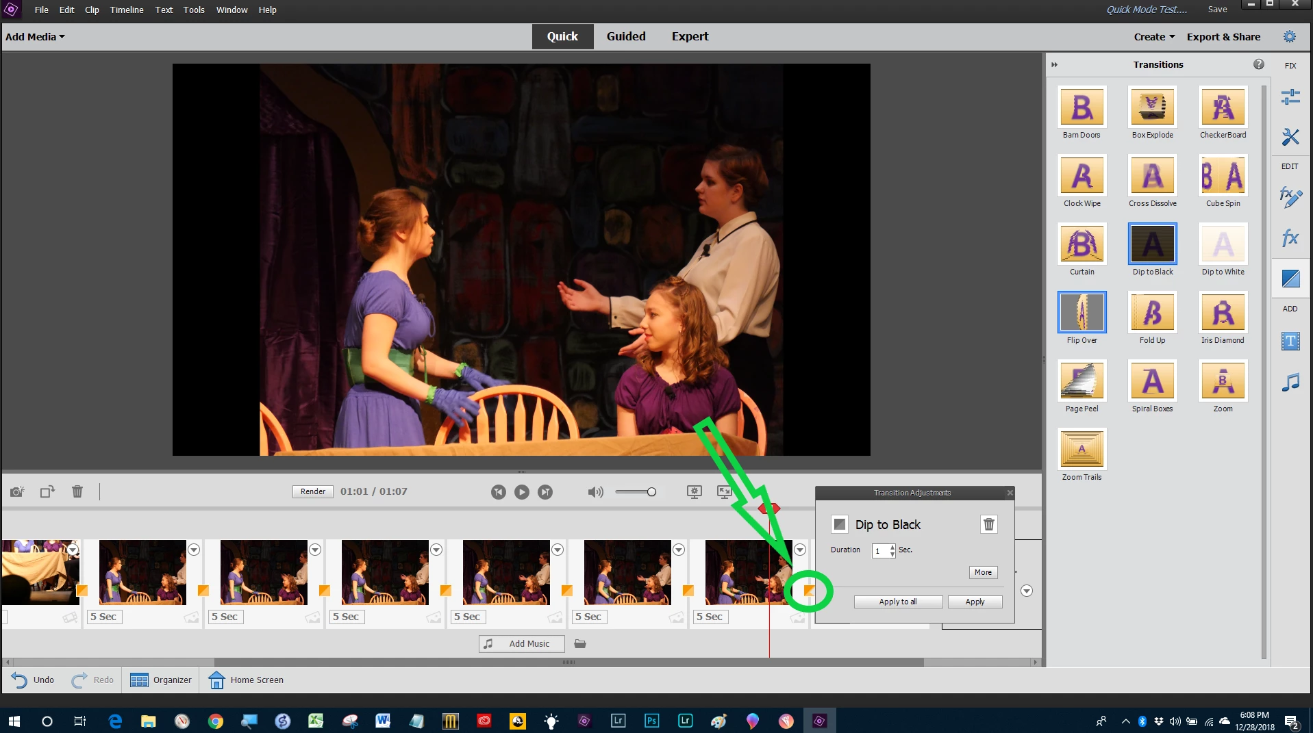

    Dec 29, 2018 1:24 AM UTC
    After you drag the transition to the clip, you should be able to click here for timing adjustments:
