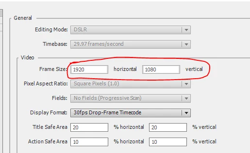

Under the program's Edit menu, what is listed on the General page under Project Settings?

Below are my project settings
