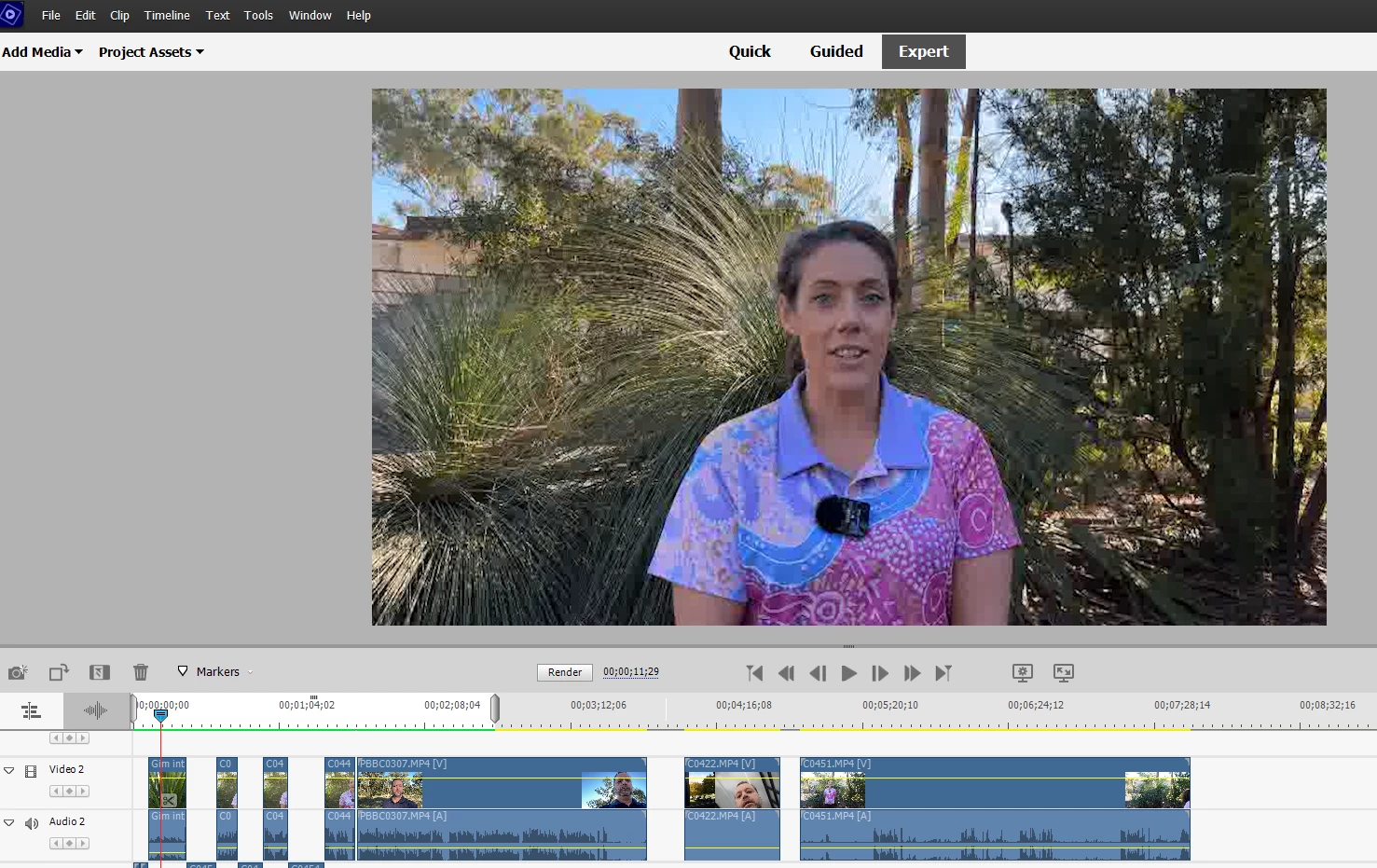

Video becomes blurry when I add it to project
I hope someone here can help. I am using Premiere Elements 2020 and am having an issue I have never encountered. I am making a compilation of many videos (both landscape and portrait) and when I add in the portrait videos they become blurry. Totally crisp before adding them. I thought maybe because they are portrait so in a separate file I reconfigured them to add a background layer that made them landscape size. I have exported in different sizes ( SD 720x480, HD 1280x720 and HD 1920x1080) They are all crystal clear until I add them to my montage and then they become blurry. I have spent hours upon hours editing this and was finally done until I realized this and its going to take hours to fix IF I can figure out how. Any ideas? Playback is on highest.

UPDATE:
Turns out one of the videos I was using had one second that was corrupt. once I edited that out and added the video back in, it worked fine! I put it into iMovie to try to see why it wasn't working and that's how I figure out that one part was corrupt.

Most likely you're looking at soft renders of the video, which will appear blurry when the video doesn't match your project settings.
To see a clear preview of your video, click the Render button on your timeline or press the Enter key. When the yellow or orange line along the top of your timeline turns green, you'll see a preview that's much closer to what your final output will look like.

Hi Steve, Im having same issues as oritl1998.  Just a recent thing that started last week. . I bring in asset video and its blurry when viewed in timeline, even after render. Ive been watching all your training videos to try figure out the problem.  Even went to project settings and started new project- set the project 3840  2160 at 30fps, checked all my cam settings and phone settings to same but nothing works. Im using Elements 2022.
May 14, 2024 1:41 PM UTC
The quality of your video depends on a) the resolution of your orignal video and how closely it matches your original video, b) your project settings and c) the output resolution for your exported video. If, for instance, your original video is shot in 4K at 30p and your project settings are set up for a 4K project at 30p and you select a 4K 30p output, your finished video should look virtually identical to your original source.
