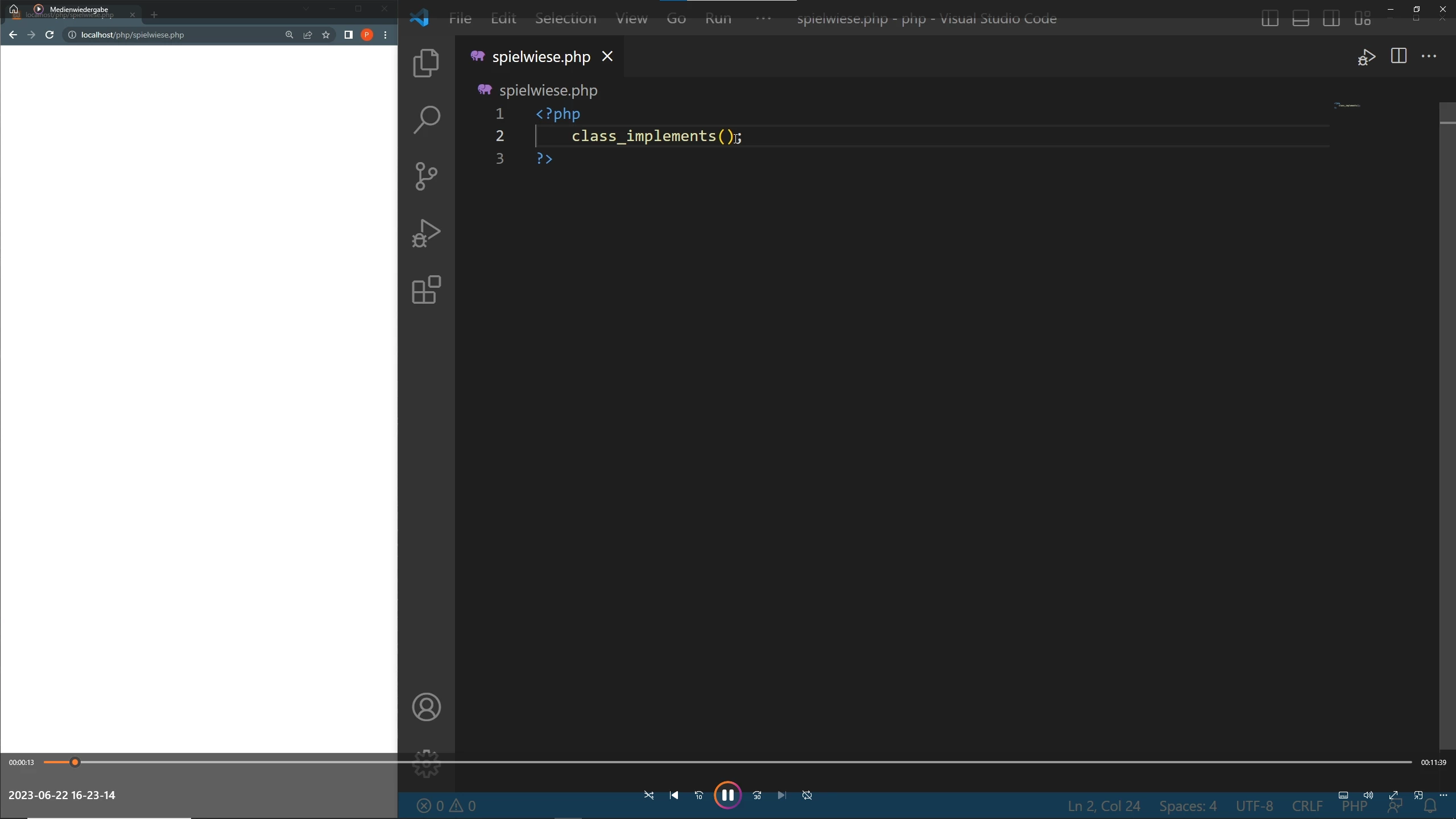

I'm also attaching a picture showing the difference between the original and the 2 exports:
