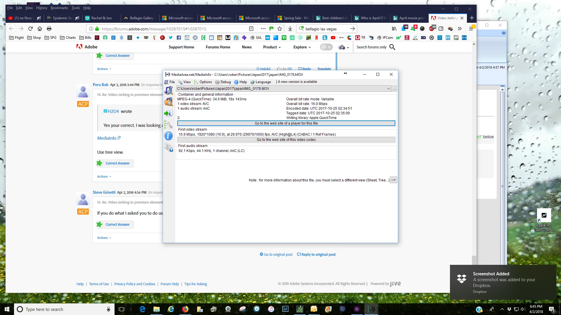

Apr 2, 2018 11:56 PM UTC
If you do what I asked you to do using MediaInfo a few posts back, the necessary report will be generated.

Apr 3, 2018 1:47 AM UTC
This is the second time I uploaded this. Is this not the data you are looking for?

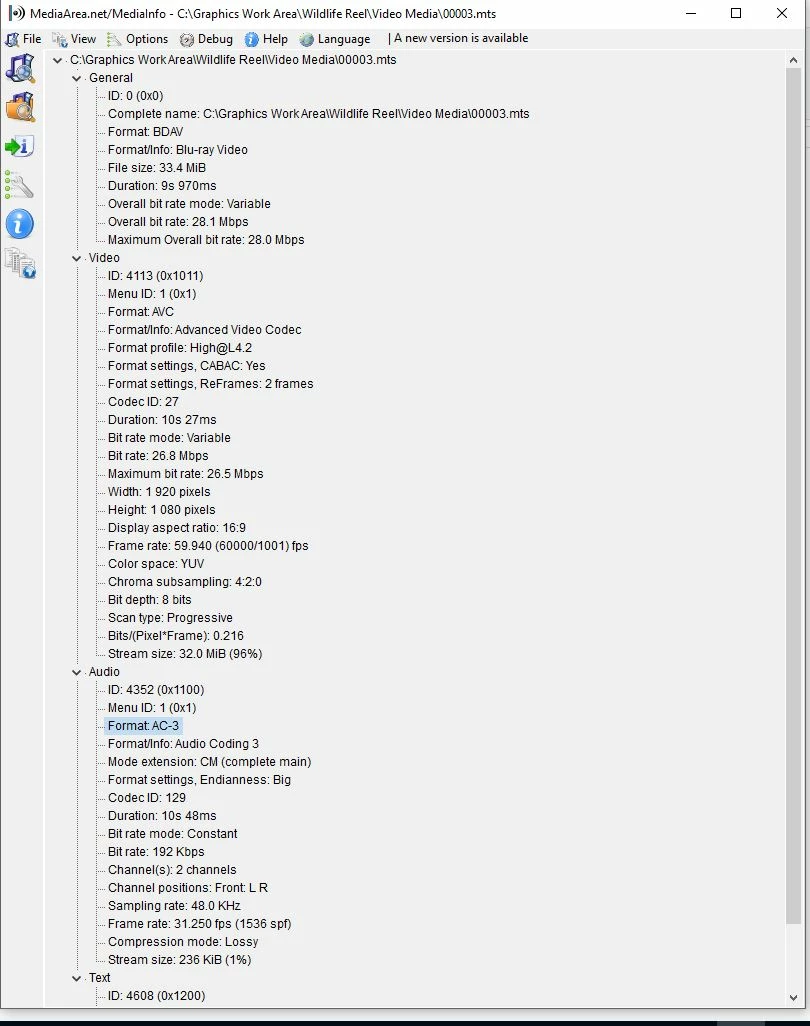

Apr 3, 2018 1:54 AM UTC
Click View and select Tree.  Then it will look more like this and include the needed information.

Yes your correct. I was looking at the file which uses .mov. Were do I get the mediaInfo report?
Peru Bob
Apr 2, 2018 10:44 PM UTC
MediaInfo
Use tree view.
