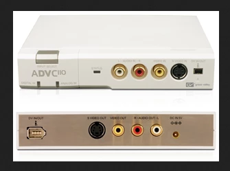

    Ann Bens
    May 31, 2017 1:46 PM UTC
    Look on ebay or something simular for a Grass Valley av/dv converter.
    They look like this:
    or find a standard definition videocamera with analog-in (this you can use as a pass through).
    May 31, 2017 8:20 PM UTC
    Your suggestion is a good one, Ann, and this used to be the go-to for analog video capture.
    However, not only is this product no longer made, but it requires a FireWire computer connection, which most current computers no longer have.
    Ann Bens
    May 31, 2017 8:45 PM UTC
    Firewire card is so cheap....
